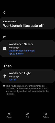

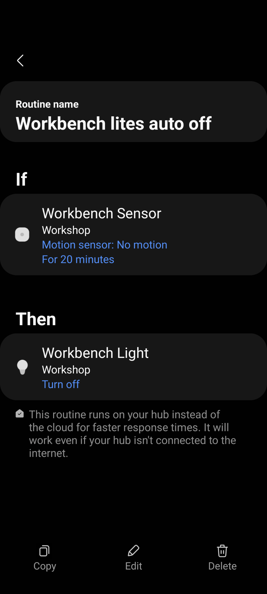

I just created a test one under iOS with no problem so ignore the question
can we see a copy of your routine?
With a simple rule like that, both of your devices involved need to be local with Zwave/Zigbee with Edge or local (aka built-in) DTH drivers. Neither can be cloud DTH or cloud-to-cloud (most wifi) devices. And both need to be on the same hub (most people don’t have multiple hubs, but its worth pointing out.)
I bet you’ll find that one or both are not local. You can check the IDE or use the Edge CLI to see.

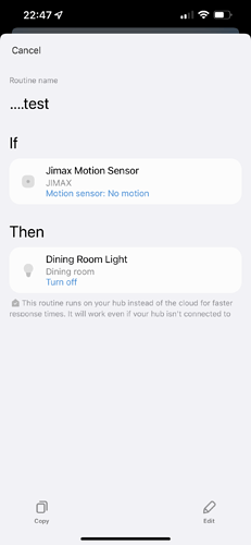

They are 100% local mate.
What model hub? What are the devices specifically? Never heard of JIMAX.
JIMAX is my cinema room.
I have the V2 hub.
Like I said. They are local mate. Here’s the same automation but without the ‘no motion for xxx amount of time’
I love it!

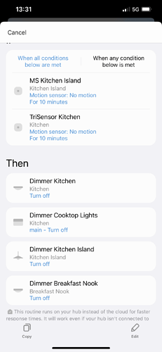

I too have V2 hubs. I duplicated your same rule with and without the “for XX minutes” on local devices and it always stayed local. Perhaps a difference in region?
Must be a region thing because I’ve seen others say it works local too, others say it doesn’t. Bizarre.
