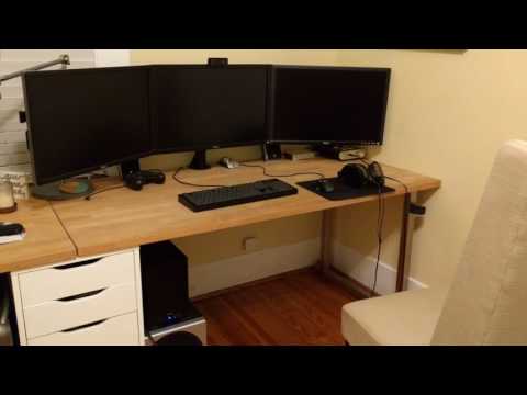

I played around with this method a bit and was able to get to it work with a PC wired directly to my primary router. However, I needed to wake/suspend a laptop over wifi, and was unable to get the wake to work with this method.
My final solution ended up being quite a bit more complicated…I believe this built-in method would be an easy solution for a simple WOL request to a PC physically wired to your LAN.
What I ended up with (Youtube link): smartthings, wol, and suspend
