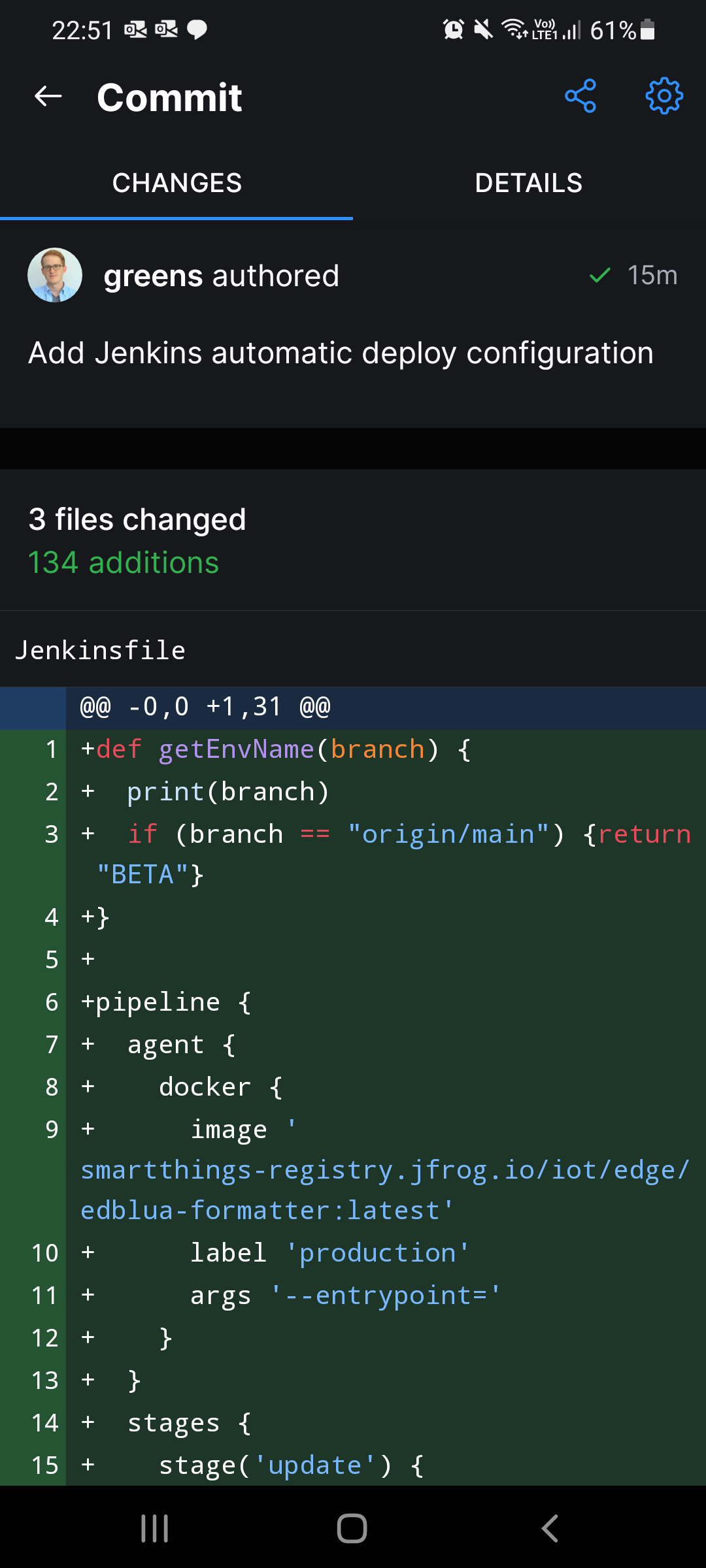

What on earth is a jenkins?
i’m guessing its how they’re going to automate GitHub pull requests publishing to the website where you install the driver.
Yeah i searched about that as well. Seems kind of an automation software for developers.lets hope this means faster driver additions and upgrades for us.
It won’t affect additions, but definitely faster from the Pull Request being submitted to them being live to install from the website. The new ones just went live on the channel URL which is faster than last week between PR acceptance and able to install.

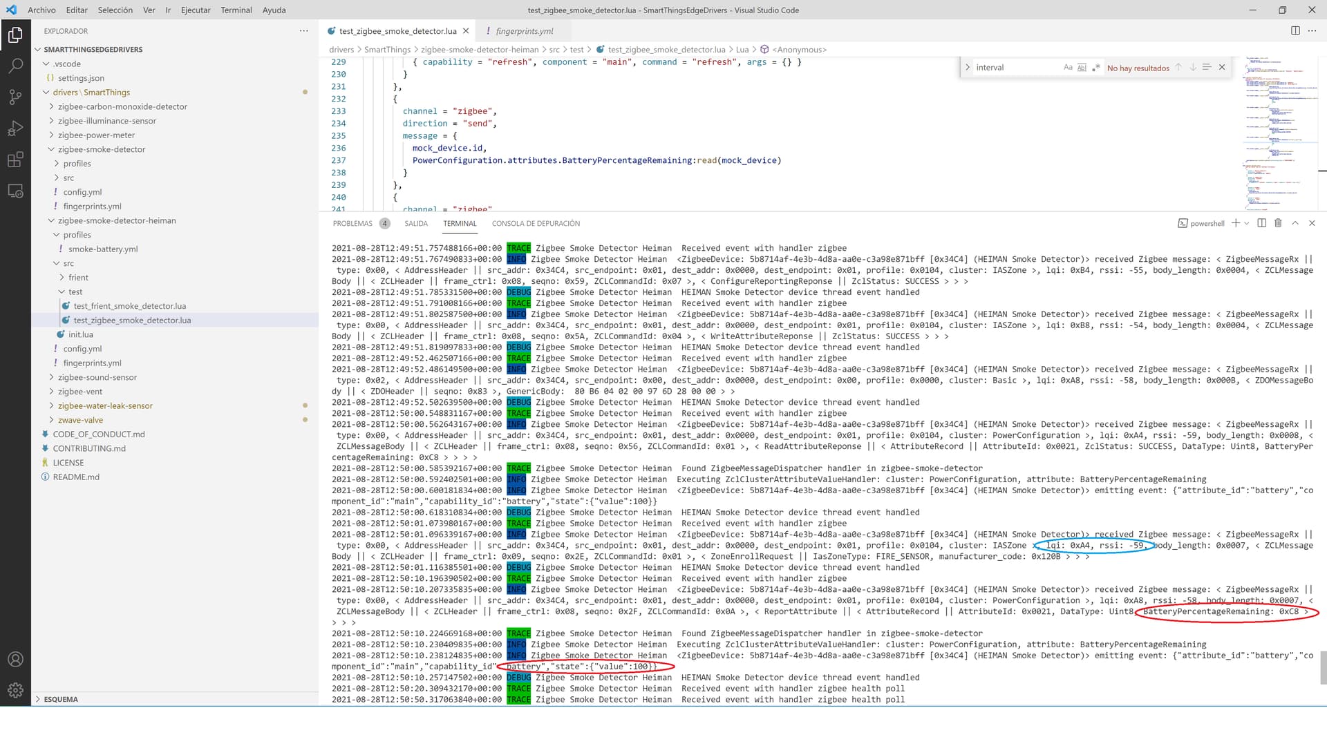

Please check if HEIMAN SmokeSensor-EF-3.0 is comparable with zigbee smoke detector.
I have this one and tried to enroll the device with Edge driver, but failed.
I hope adding finger print wil work for this driver.
And…I registered heiman carbon monoxide detector and aeotec z-wave range extender with edge drivers from you.
Both of them are working good, but icon from ST device is ugly…(default Null icon is applied)
Please update this.
Many Thanks!!
Adding this to the fingerprints.jml file works the same as the other originals.
I have 2 working from the beginning and they go well, except that in the mosaic it shows searching, or without connection but it is not true
    deviceProfileName: smoke-battery
  - id: "HEIMAN/SmokeSensor-EF-3.0"
    deviceLabel: HEIMAN Smoke Detector
    manufacturer: HEIMAN
    model: SmokeSensor-EF-3.0
Adding this at end of smoke-battery.yml the icon is always displayed correctly
metadata:
  deviceType: SmokeDetector
  ocfDeviceType: x.com.st.d.sensor.smoke
  deviceTypeId: SmokeDetector
Oh this works!! many Thanks~~
