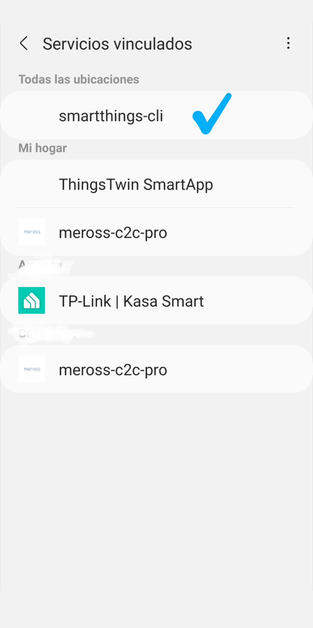

Yes it runs local, but it is seen in IDE as type placeholder and in the app it is in linked services.
The information of the zigbee connection metrics between the device and the hub has also been lost.
