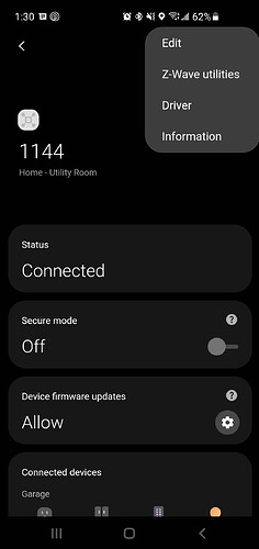

I just noticed that on hub details page now we have installed drivers listed
Must be to do with dev mode on perhaps ? Mines off and it is not there which makes sense
If I turn dev mode on my whole layout gets mixed up so I don’t bother now
Yes it has been there for a week now for people who have signed up for the beta

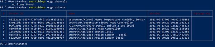

Just to clarify do i need to install lua for this or just the smartthings API?
Just the CLI.
Thanks. When i check for the drivers. It says that i am not enrolled to any channels.
On the drivers however it gives me some custom dth i have. I suspect i have the same issue with @Mariano_Colmenarejo .
Sorry for tagging you again but the bloody reply on comment button does not work… @psbarrett
At least installing the drivers works and i was able to install the zigbee motion sensor driver.
