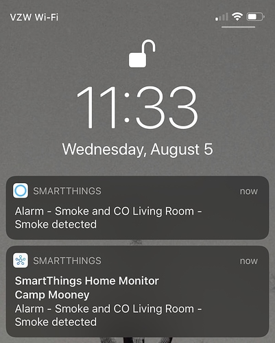

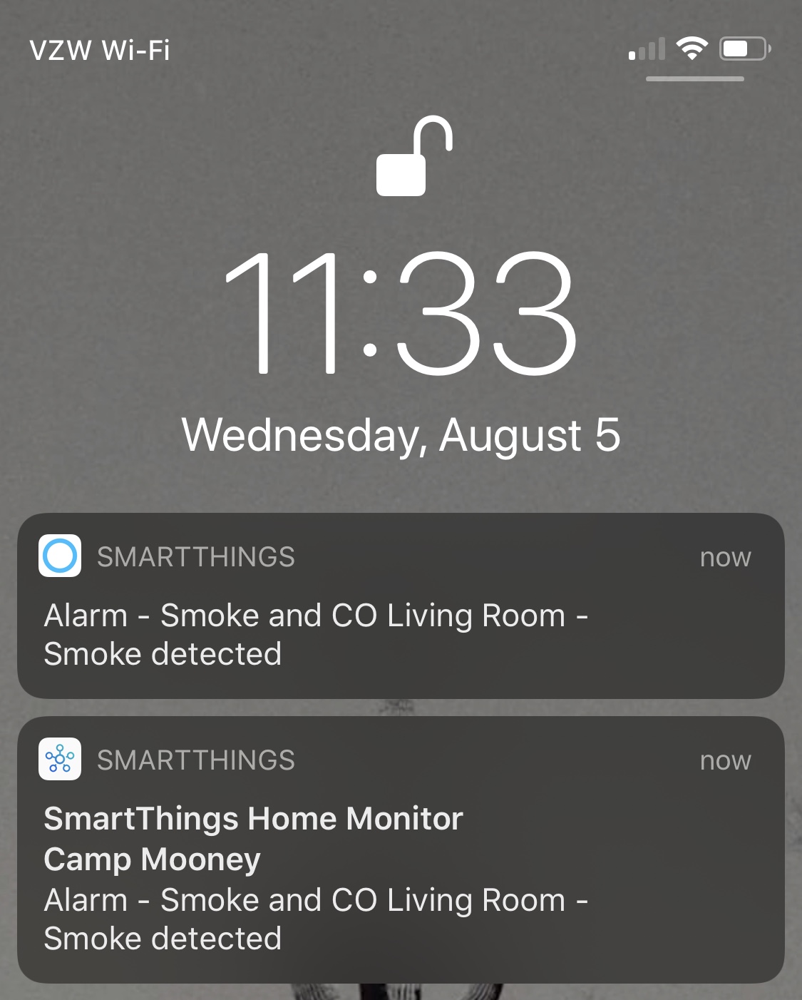

Stranger still — the downstairs smoke alarm went off went we burned some bacon, the notification showed for both old and new app, but this device doesn’t even show in the list on the new app (it’s the same device showing “offline” in the new app if I look at the fire alarm monitor).
