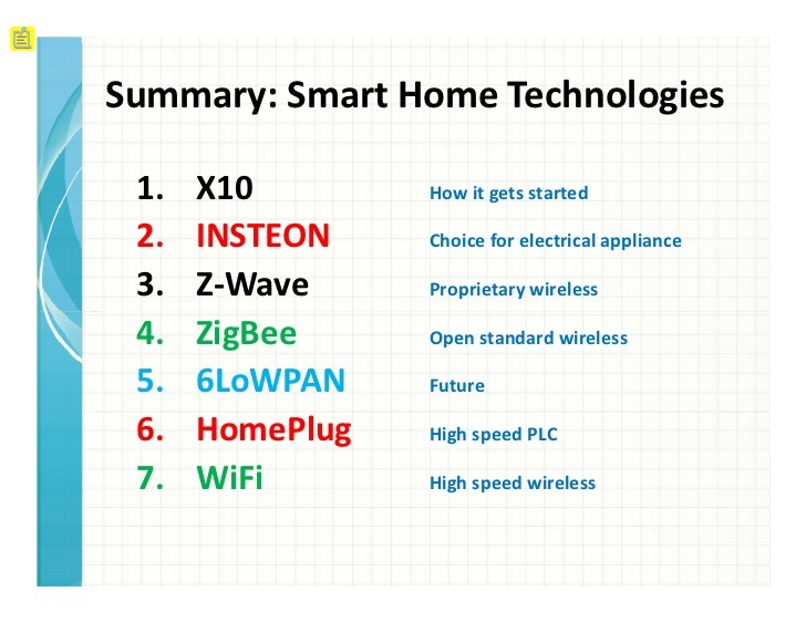

I cannot replace any of my switches because of the cost, and they are already perfectly controlled by X10. I still have several X10 switches and handheld remotes that are rock solid in their operation, using the existing neutral house wiring and a unique broadcast band for handheld remotes.
Z-Wave and Zigbee definitely have their growing operational issues with distance coverage in this day and age of larger homes and more wireless broadcasting devices. I have tried the other solutions below, and none are a clear winner.
