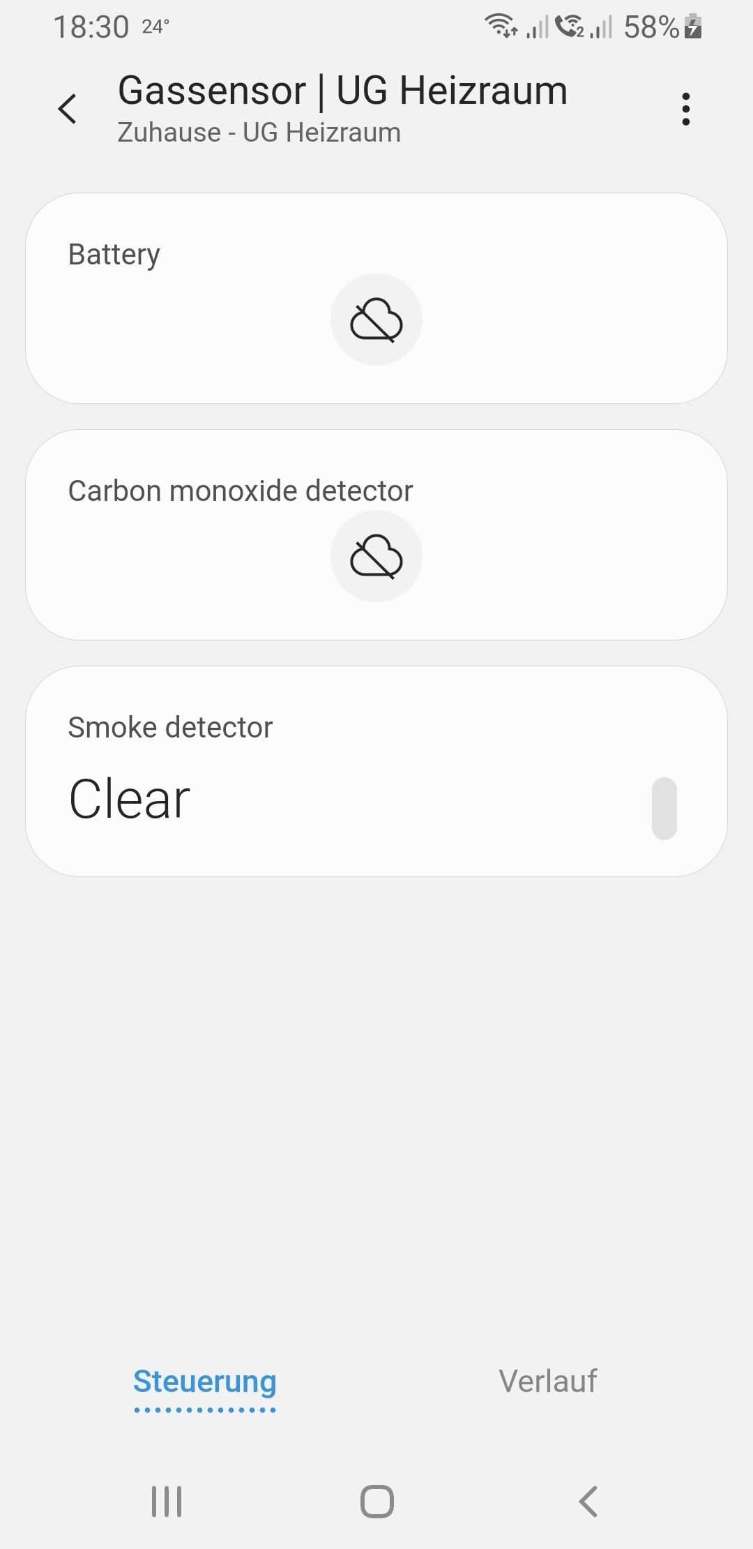

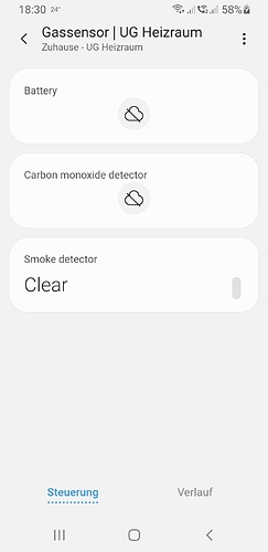

What the new ST app show me is the following:
I wonder from where the new app gets the information to show the “Battery” and “Carbon monixide detector” capability?
Is there a way to reliable work around this?
I assume that this is caused by some tries while implementing and testing the DTH.
Is there a way to “reset” the DTH information for my device somehow (without need to reinclude the whole device)?

If you were testing other DTH’s, then it’s likely you’ve got some caching issues (known) when editing DTH’s and the new app. You can swap to another DTH and then back to yours and the tiles should change. My gut feel says it won’t.

I tried this already, and your feeling is right - the tiles do not change.

Before trying your own VID, I noticed that ST has one for the Orvibo sensor. You might want to try adding this to your code’s metadata → definition line and see if it does anything:
, mnmn: “SmartThings”, vid: “SmartThings-smartthings-Orvibo_Gas_Sensor”)
You may need to do the DTH swap or clear cache trick…
Is the Gas Detector capability not working in the app yet?
Well is there any?
I didn’t find that capability in the ST capability reference therefore I was not aware that there is such a cabability and used the “Smoke Detector” that brings all I need in my opinion. But I’ll give that a try, thanks for the hint.
This seems to look a bit better as it only shows the “Gassensor”, but still the “Battery”. In the order “Gassensor” then “Battery”. And also I like that the texts are localized now.

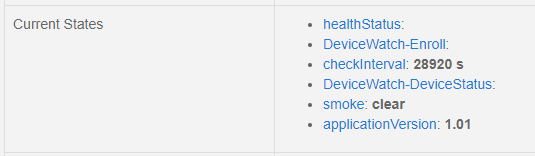

Does your device have non-null states for the battery and gas sensor in the IDE?
Sorry, but now my ST know how is at the limit :thinking:.
What excactly do you mean with “non-null states” in the IDE?
When you view the device page at https://account.smartthings.com do all of the states have a value?
Aah ok - these are the current states and their values:
This should be that what you wanted to know, right?
There is no “battery” state at all.
The “smoke” represents the “gas” state.
