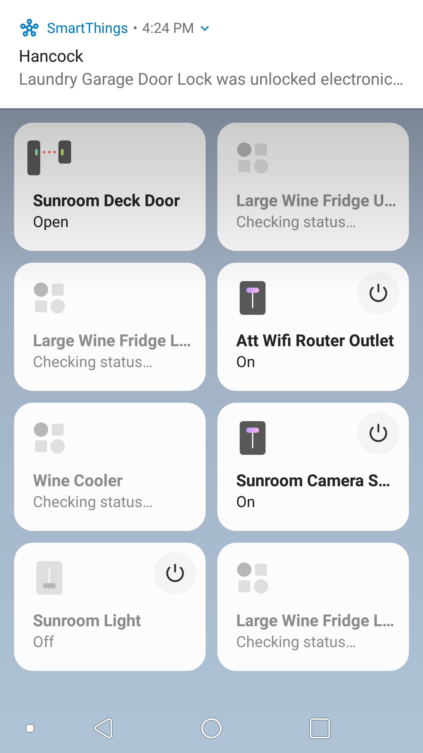

Another question for developers. Code for default tile/value
In the new mobile app there is a value shown on the default tile… I have some older device types namely the st814, a homi gas detector etc. that dont show a value just. “Checking Status”.
Does anyone have device type code examples that show how to enable this and show a value there. The examples in the ide (when creating device handler from example) still seem to be very old an dont have this code.
Thanks in advance
‘Checking status’ has been encountered on mobile devices that are not set to US English, but on my UK English devices it usually means the device handler has declared capabilities but not yet populated all the associated attributes with valid values and units. You will notice more recently updated device handlers make a point of initialising attributes.
In particular, specifying attribute units in events at least once can make a difference. Even though capabilities often have default units, the app seems to like them being explicitly defined.
What attribute you actually end up with on the tile rather depends on what capabilities you have defined. But that’s another battle.

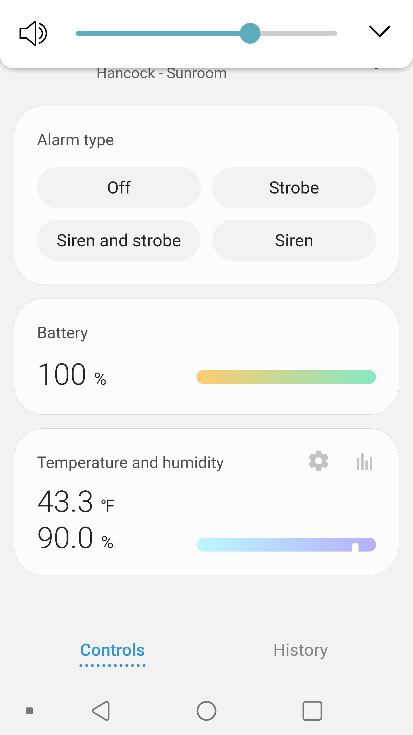

Hi @Lgkahn,
In the device configuration presentation, you specify which capability is displayed in the different views (dashboard, detail, automation). When you create it, the assigned VID must be added to the DTH definition. For example:

In the picture below, you can see the device without defining the device UI and with the configuration shown in the sample above respectively.
temperature_dev_config

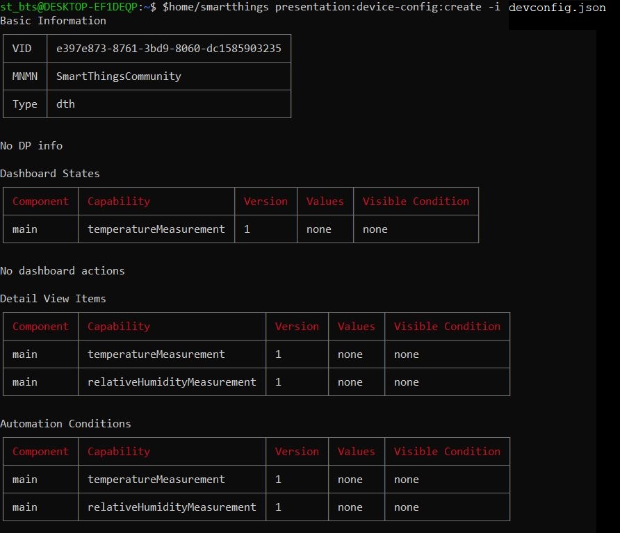

Here are the steps to create the device configuration presentation:
  1. Your DTH must be saved and published, take its ID (the alphanumeric value in the URL).
  2. Use the tool to generate a standard presentation. You should see all of your defined capabilities in each view
smartthings presentation:device-config:generate dthID --dth -j
3. Copy that output in a JSON file and edit it, in the dashboard view you could leave only the Temperature Measurement capability in the “states” property, “actions” in the same view is for those capabilities that can receive a command, such as Switch.
4. Create the device config presentation and take the VID and MNMN values onto the DTH.
To see that presentation in JSON format, you could use the command:
smartthings presentation VID -j
Those commands are listed in the SmartThings CLI Readme and you can also check this document to see the API requests to generate and create the device configuration.
thank you getting closer… i did as you outlined and even saved the new vid in the device handler and republished but still getting “checking status” on the dashboard view
ie
C:\st>cli-win presentation:device-config:generate 7e6bf0ba-7cb0-40a1-876a-a56adcd2084c --dth -j > st814.json.orig

C:\st>cli-win presentation:device-config:create -i st814.json.new
mnmn: SmartThingsCommunity
vid: 97ba8873-f610-3322-a2be-ec1650316228
type: dth
dpInfo: null
iconUrl: null

C:\st>cli-win presentation 97ba8873-f610-3322-a2be-ec1650316228 -j
“mnmn”: “SmartThingsCommunity”,
“vid”: “97ba8873-f610-3322-a2be-ec1650316228”,
“iconUrl”: null,
“dashboard”: {
“states”: [
“label”: “{{temperature.value}} {{temperature.unit}}”,
“alternatives”: [
“key”: “C”,
“value”: “°C”,
“type”: “active”,
“description”: null
“key”: “K”,
“value”: “°K”,
“type”: “active”,
“description”: null
“key”: “F”,
“value”: “°F”,
“type”: “active”,
“description”: null
“group”: null,
“capability”: “temperatureMeasurement”,
“version”: 1,
“component”: “main”,
“visibleCondition”: null
“actions”: ,
“basicPlus”:
“detailView”: [
“version”: 1,
“label”: “___PO_CODE_SMARTTHINGS_DREAM_SAC_TMBODY_TEMPERATURE”,
“displayType”: “slider”,
“toggleSwitch”: null,
“standbyPowerSwitch”: null,
“switch”: null,
“slider”: {
“range”: [
-20,
50
“step”: null,
“unit”: “temperature.unit”,
“command”: null,
“value”: “temperature.value”
“pushButton”: null,
“playPause”: null,
“playStop”: null,
“list”: null,
“textField”: null,
“numberField”: null,
“stepper”: null,
“state”: null,
“multiArgCommand”: null,
“capability”: “relativeHumidityMeasurement”,
“version”: 1,
“label”: “___PO_CODE_SMARTTHINGS_DREAM_SAC_HEADER_HUMIDITY_CHN”,
“switch”: null,
“slider”: {
“range”: [
0,
100
“step”: null,
“unit”: null,
“command”: null,
“value”: “humidity.value”
“pushButton”: null,
“playPause”: null,
“playStop”: null,
“list”: null,
“textField”: null,
“stepper”: null,
“state”: null,
“capability”: “battery”,
“version”: 1,
“label”: “___PO_CODE_SMARTTHINGS_DREAM_SAC_TMBODY_BATTERY”,
“switch”: null,
“slider”: {
“range”: [
0,
100
“step”: null,
“unit”: null,
“command”: null,
“value”: “battery.value”
“pushButton”: null,
“playPause”: null,
“playStop”: null,
“list”: null,
“textField”: null,
“stepper”: null,
“state”: null,
“automation”: {
“conditions”: [
“version”: 1,
“displayType”: “numberField”,
“slider”: null,
“list”: null,
“numberField”: {
“value”: “temperature.value”,
“range”: [
-20,
50
“textField”: null,
“emphasis”: null,
“version”: 1,
“slider”: null,
“list”: null,
“numberField”: {
“value”: “humidity.value”,
“unit”: null,
