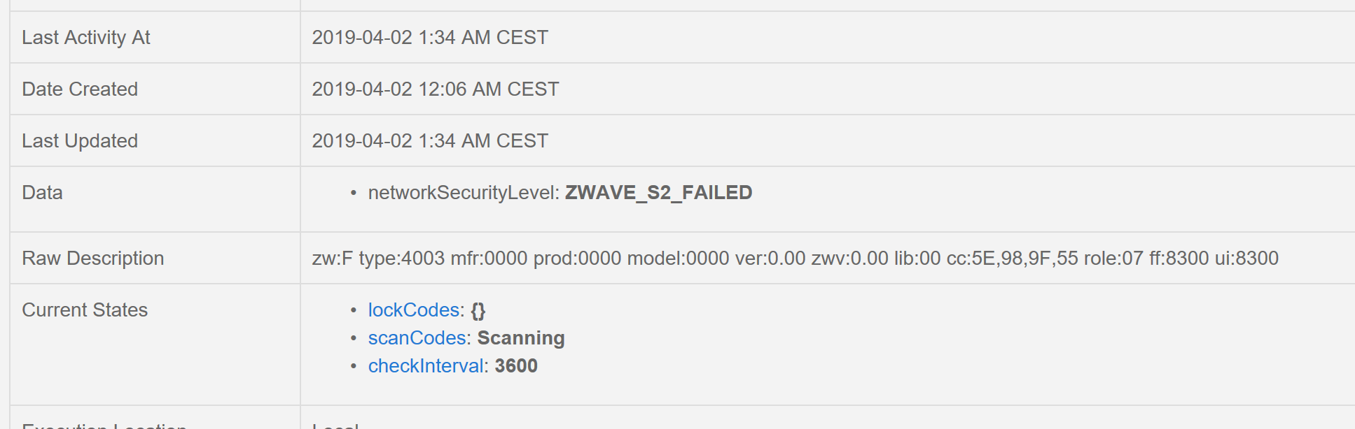

I have added approx 20 identical Z-wave locks to my V3 Hub all coming up with ZWAVE_S0_DOWNGRADE and a RAW string with “good” values and the Z-wave locks are working 100%. Now, when I am adding new identical Z-wave locks on the same hub it shows ZWAVE_S2_FAILED and the RAW string have “no” values so the Z-wave lock does not work at all.

If the raw description is full of 0’s that indicates that the Node Information Frame request wasn’t successfully processed by the lock. Try to reboot your hub and bring your lock closer to your hub and try it again after excluding it.

I agree that full of 0’s indicate that the frame request wasn’t processed correctly, but at when I try to pair the same lock on another identical hub it works (resulting in Zwave_S0_Downgrade). As I explained, the first 15-20 locks was paired successfully with ZWAVE_S0_Downgrade but it seems the hub got a switch (stuck in Secure/S2 mode?) as all locks now gets S2_Failed. Even if I unpair and repair a S0 paired lock it ends up with a S2_failed scenario.

Know I know the DTH abbreviation and that we are using the “Z wave lock out of the box” DTH. I will in some hours take another Hub and pair 10-20 new locks to see if the problem occurs again on another hub. If it does it seems to be some kind of problems when a certain number of locks are paired. My goal is to have approx. 200 locks to one single hub.

When I tested with another Smartthing V3 hub, this time the first 13 locks was paired with S0_Downgrade. Then the next 2 was paired with S2_Failed.

Yes, your issue with the lock pairing is being looked into and they a patch in the works, it’s a platform issue AFAIK.
