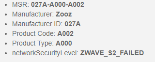

I also have a Zooz Zen27 (v1) switch downstream from the ring extender, which i’ve reset/excluded & re-added but it is still showing ZWAVE_S2_FAILED>
Should the Zooz also connect as S2?

Per https://www.thesmartesthouse.com/products/zooz-z-wave-plus-s2-dimmer-switch-zen27-with-simple-direct-3-way-4-way " - “S2 security for a smarter and safer connection”.
@Speeder when you added the device did you scan a barcode or manually enter the DSK/Pin for the device?
it did not prompt for a PIN for the device. I simply did the “scan nearby” in the new app and it found the device after i tapped up paddle 3 times.
