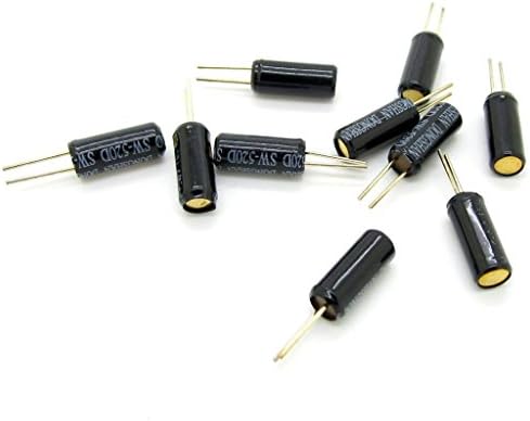

I had very good luck with
connected to a contact sensor.
If you don’t mind soldering,
is an option.
