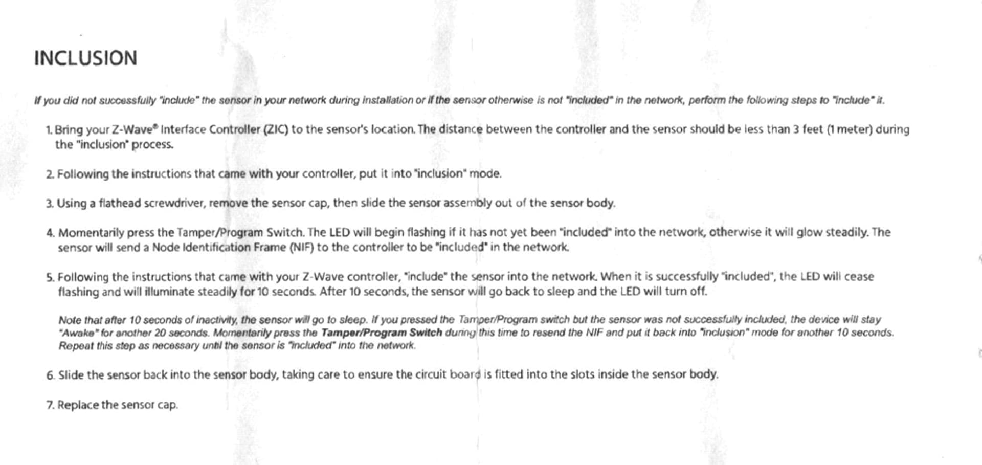

Thanks for sharing the manual above! I couldn’t for the life of me find mine, and I keep all my ST papers together.
I had to remove my sensor to swap it to an Edge driver. Even though I removed the device both in the app and in the device list through the ST Hub device list, I had to Exclude it using the Smartthings app, Z-Wave Utilties - Z-Wave exclusion. Once it was searching for a Zwave device to exclude, I pressed the tamper button on the sensor for about a half a second and app showed that it had found a device to exclude.
To include, used the ST app to add a nearby device. While it was scanning for a device, again, pressed the tamper button for about a half a second, and then waited another 5-10 seconds and it showed that it was added.
If you have issues, you may need to attempted this a few times.
