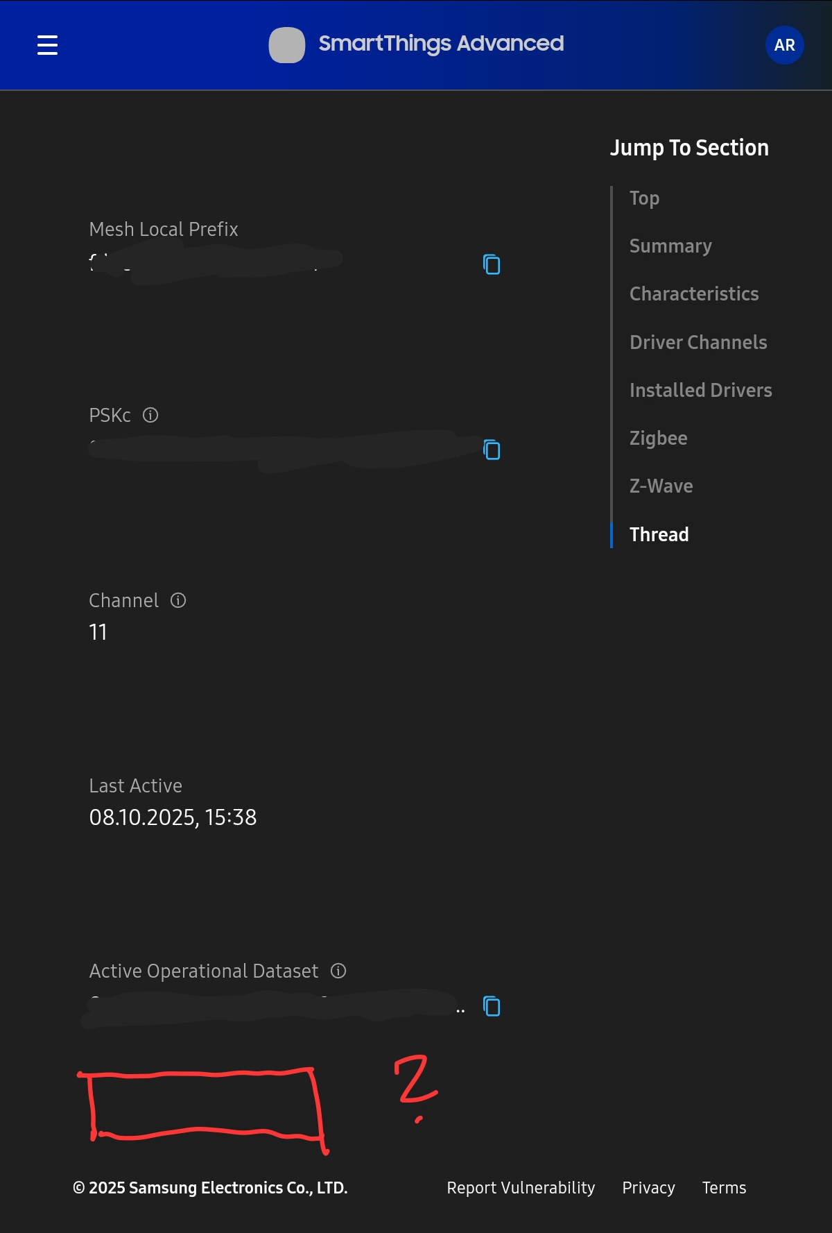

… but on my V4 it’s gone. Nuki app shows that there’s no connection between the lock and the cloud:
The setting is also missing in the AWA:
Mentioned here and I can confirm that I had this setting before:

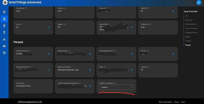

I found another user who owns both hubs - the V3 and the V4. He confirmed that the V4 is missing NAT64 support. Hopefully, this isn’t a fundamental issue, since NAT64 will become increasingly important in the near future.
Here are two screenshots he provided:
V4:
V3:
