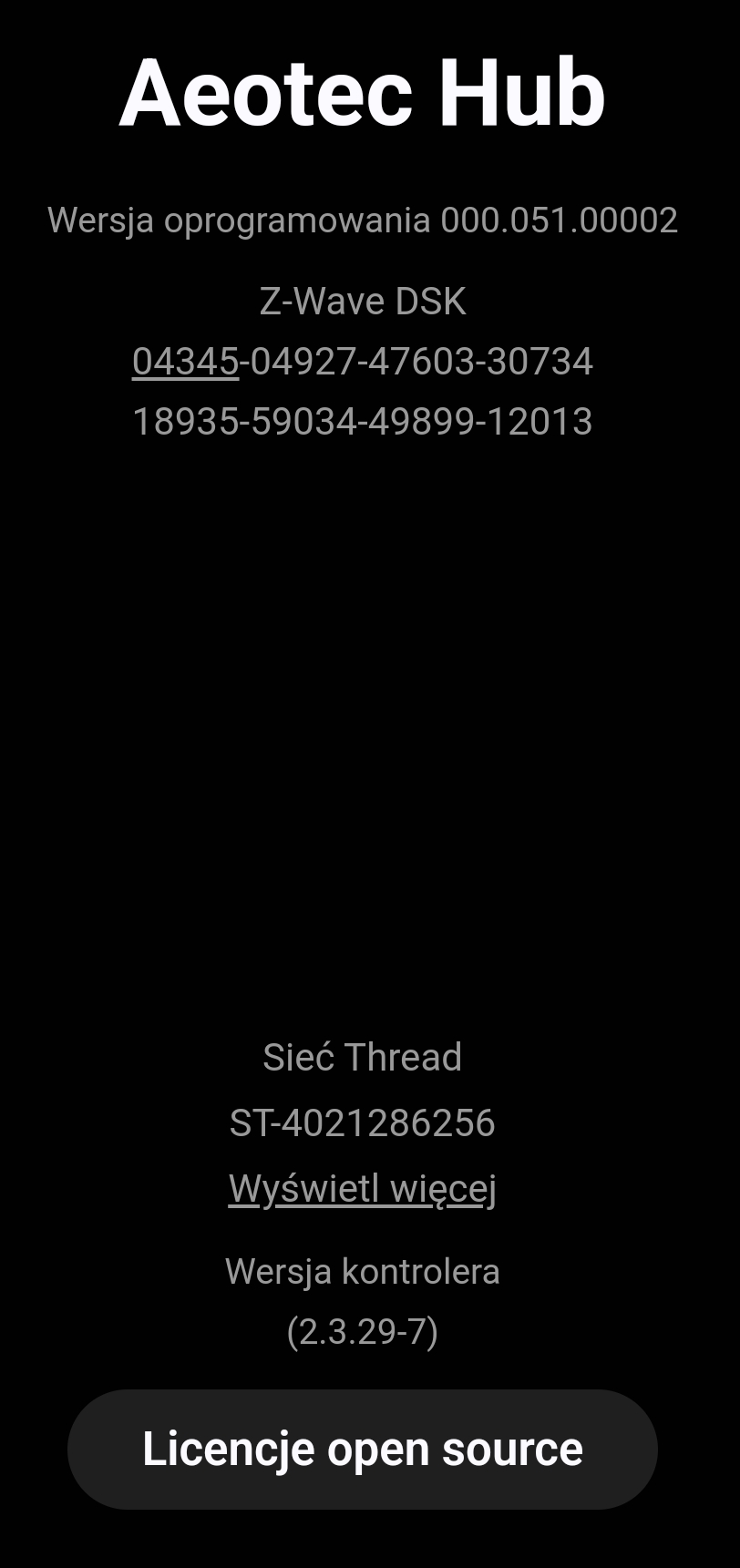

what is the firmware version of your hub? Your mobile device or tablet is on the same 2.4 ghz network?
