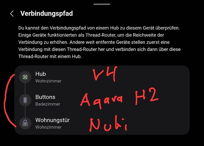

My Nuki Ultra prefers the Aqara H2 Wall Switch in the bathroom over the direct connection to the hub, which is only five meters away:

My hub is about 5 meters away, the Aqara H2 in the bathroom about 20 m behind a wall/door. I have never seen the Nuki Ultra directly connected to the hub. For a while it had a relationship with the Nanoleaf Essentials strip in the kitchen. I have plenty of Thread routers in every room and it still chooses the weirdest connections.
Edit: to be precise, not every device that can be a router becomes a router in the mesh network. It’s highly dynamic and it’s not really the end device that makes the decisions.
