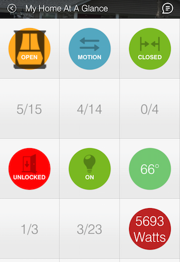

I posted last week a little hack to show all my open windows:
Well, I’ve created a Whole House View so that I can see all kinds of other information in one place:

One place to see all the things I care about. Open windows, open & unlocked doors. The average temp in the house (average from every sensor) & the current energy usage. Three of those have no dashboard equivalents.

I think I figured out the required field. I change them to false and was able to get the app installed. But when i go into the At A Glance I get – for all my items. Also, in the Thing section I don’t see the device that was created however on my iPhone I do see the device.

Just pushed up a new version of the SmartApp that should help if you don’t have all the devices that I have. The SmartDevice will still report invalid settings for them. But you can easily remove them from the gui:
That is the list of the tiles, if you remove any of them from lines 96-99 they will no longer show up.

So far so good. A few things I noticed.
  1. Took a bit of time for all the sensor to populate in the Smart App.
  2. Aeon Energy Meter v1 is not showing up.
  3. Door Sensor would not show until added Window Sensor. I have not yet tried to turn off the window sensors to see if that makes a difference. Will try later.
This is a very useful app for me. Run easier than the native ST dashboard. Well done!
