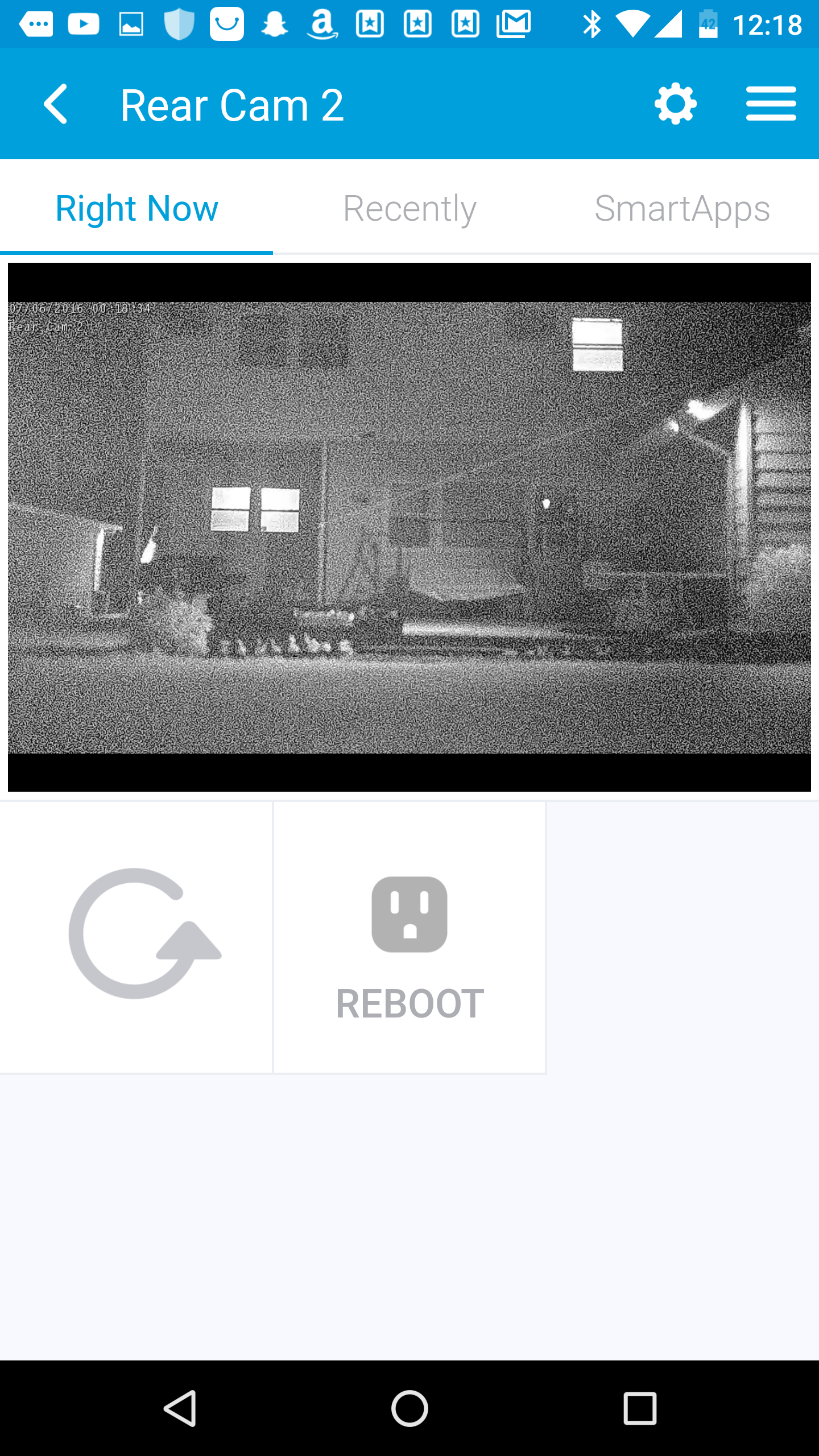

Now on to my next question. I have 3 cameras outside with poor lightning at night and despite having a seperate IR light, they get grainy video at night. If I want to use video motion detection, will this trigger recordings all night since the video gets super grainy at night?
