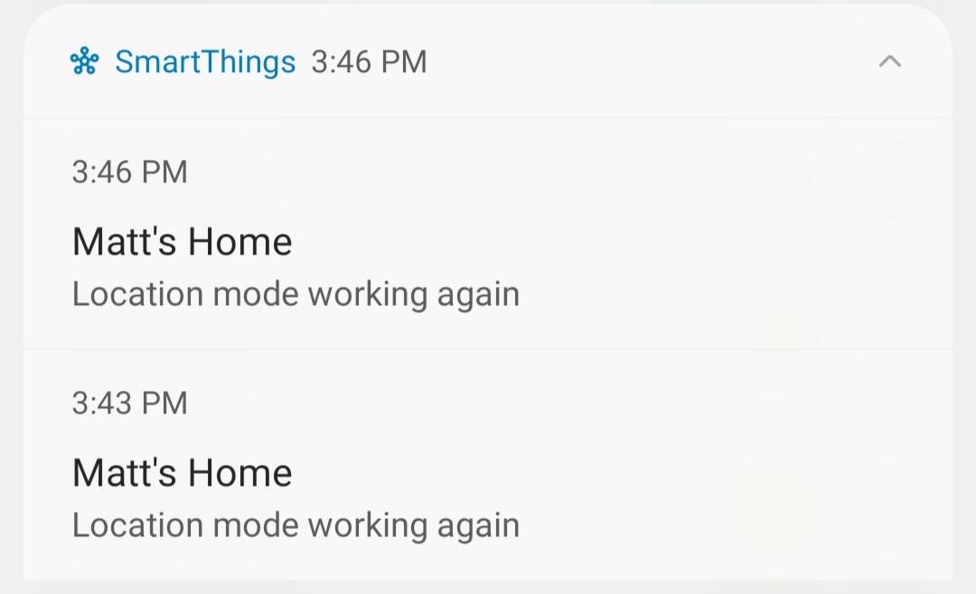

Yesterday I noticed things weren’t trigger. After a little digging I quickly noticed that location modes weren’t actually firing. Digging into the logs I saw this template.
I haven’t changed anything in weeks… Anyone else having this issue?
