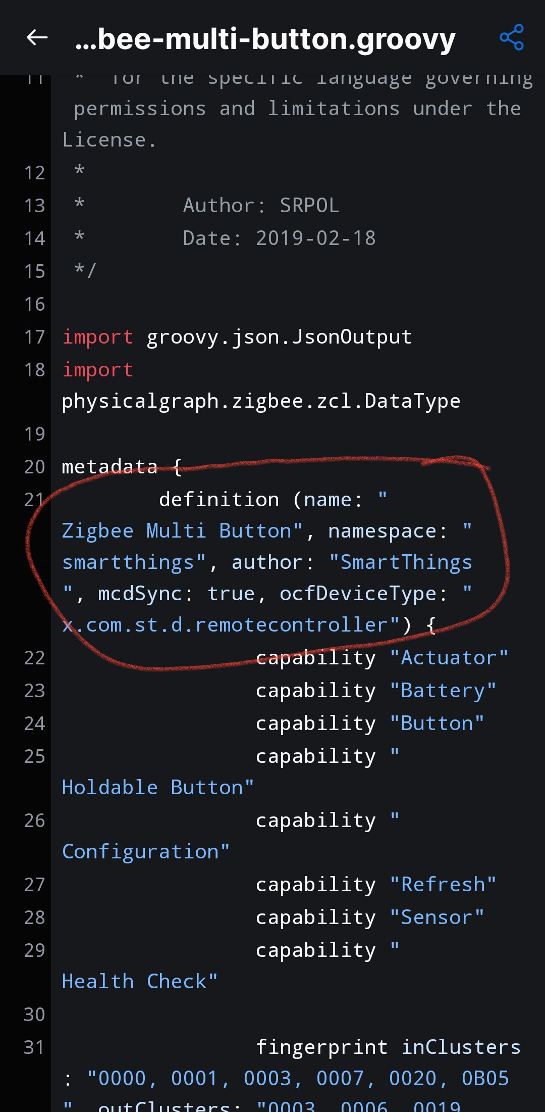

Tried zigbee multi button for the ikeas? I cant remember - I think @jkp did some of those…
@JDRoberts loves buttons
Yeah its scary…
So the zigbee multi button runs local?
Without scanning the dth… Dont know. I do know that if anything has a chance to that one might. I usually just go to town trying DTHs and seeing the effects. If you switch it in the IDE it will tell you instantly in the device list in the IDE if its local.
Other way is to scan through the SmartThings Github and look for the islocal flag in their dths. (its not 100% but better than a guess)
Id use the swap and pray method personally. It takes about 5 minutes.

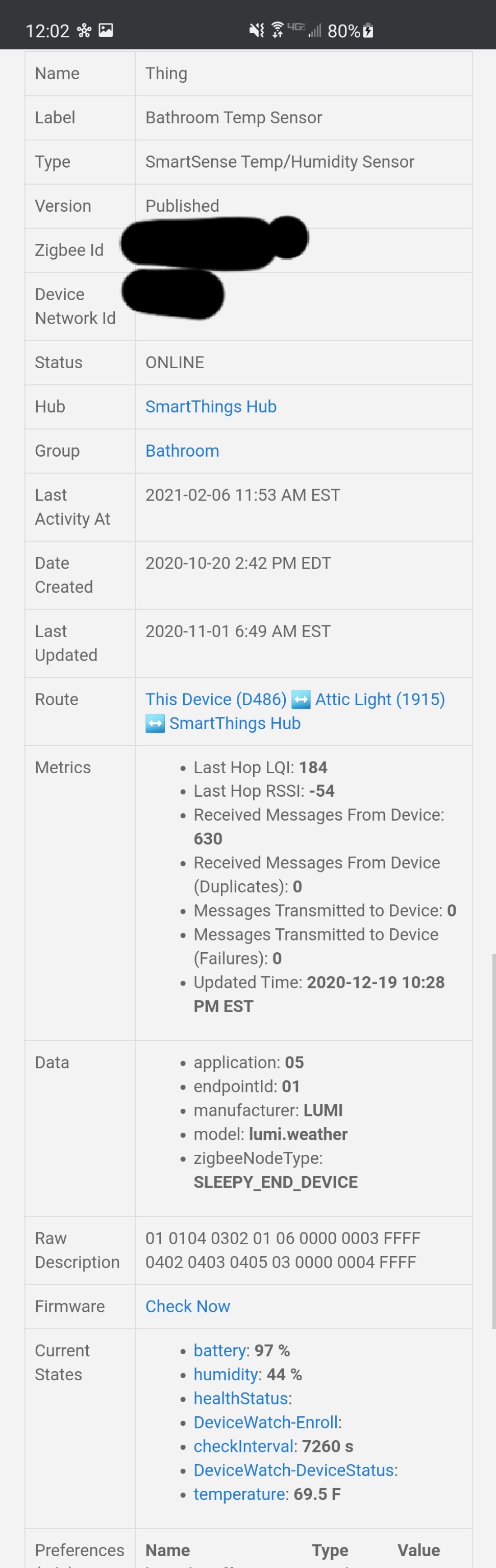

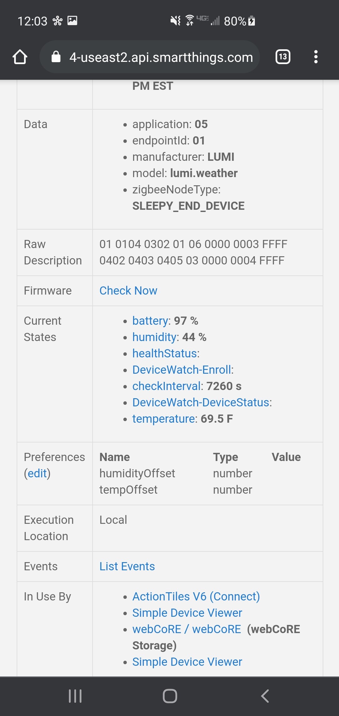

XIAOMI AQARA HUMIDITY SENSOR
You can use Smartsense Temp Humidity Sensor.

The ikea one does not work. Did you test the aqara one?
