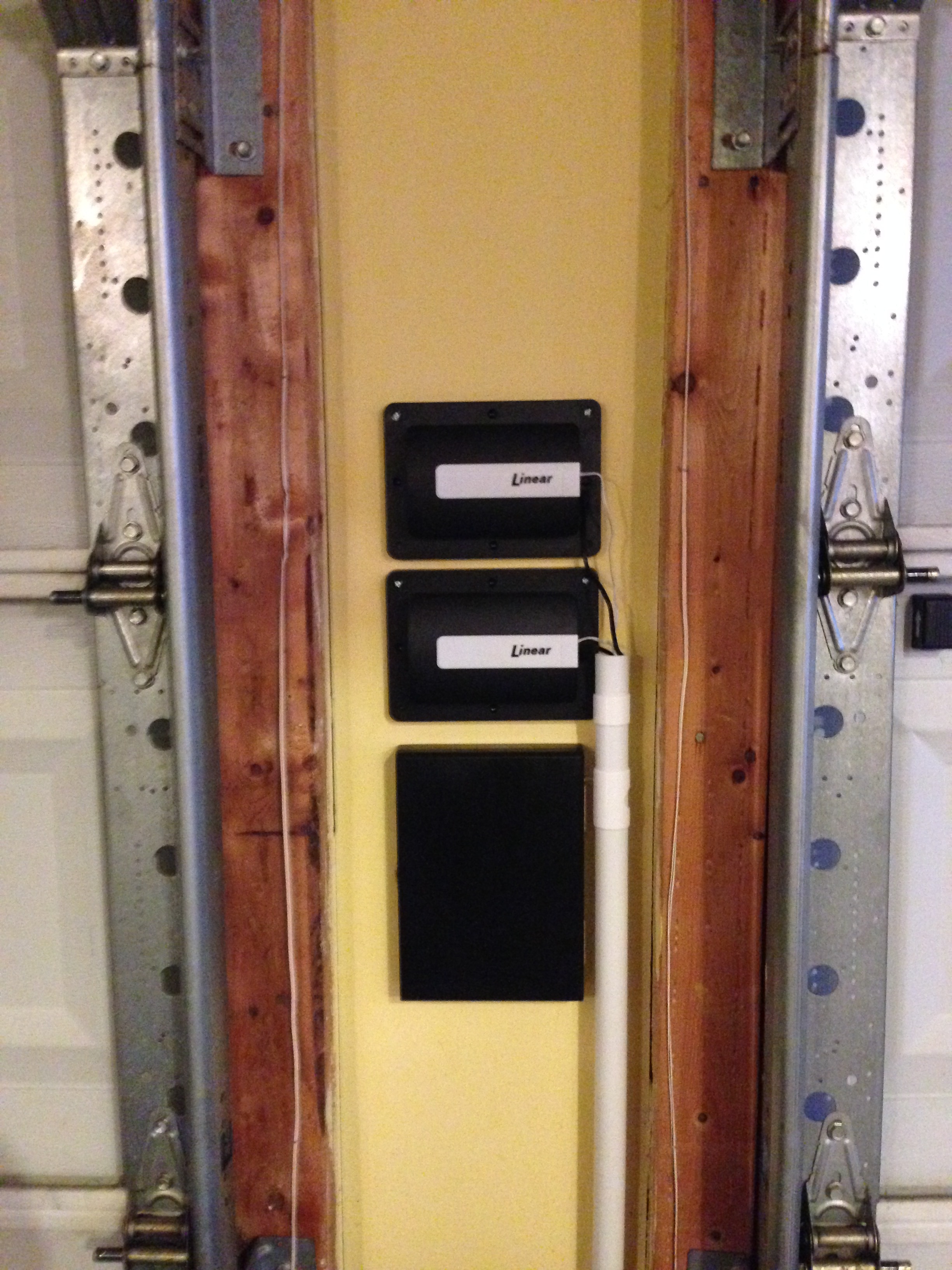

My brother-in-law had the great idea of taking the circuit board out of the remote’s housing and putting it in a larger box, namely, a black wooden cigar box. The soldered circuit board is nice and secure in the cigar box, and it even looks nice and neat on the wall. Here is a picture, I would have posted more but since I am a new user on the forum I can only post one pic:
Here is a picture of what the KLIK1U looks like in the re-purposed cigar box. It is screwed in securely on standouts and is kept high and dry in the box. Normally the box door is closed but I opened it up for purposes of sharing this picture.
Also, my wife confirmed that the system works perfectly with voice control through the Echo. When my wife walks into the kitchen, she says, “Alexa, tell Vivint to close the garage doors.” And Alexa says “Ok” and closes both doors.
One more pic to show what the system looks like in the garage. I keep my garage fairly tidy so keeping the wire clutter at a minimum was a prerequisite.
