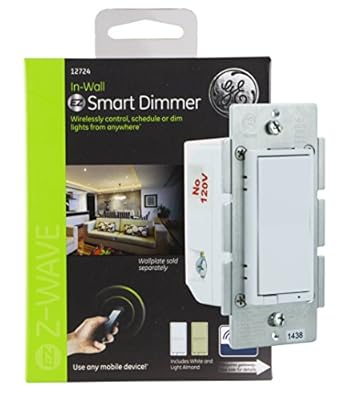

BTW I use this dimmer and they work great together:
Thanks. Yeah, that is the same switch I ordered. This will be my first dimmable, but for a media room, I think it is a must.

Is there a way to program the GE switch for manual “ON” at 50-60%? I don’t have a dimmer, and am not completely sure how they function. (Good news is I will have mine sometime tomorrow).

The GE dimmer will return to its last setting when you turn it on, so there’s no need to program it.
Btw, some LEDs won’t turn on with less than 5% power. So if someone dims the lights <5% before turning them off, it might seem like the switch doesn’t work when you turn it back on.
