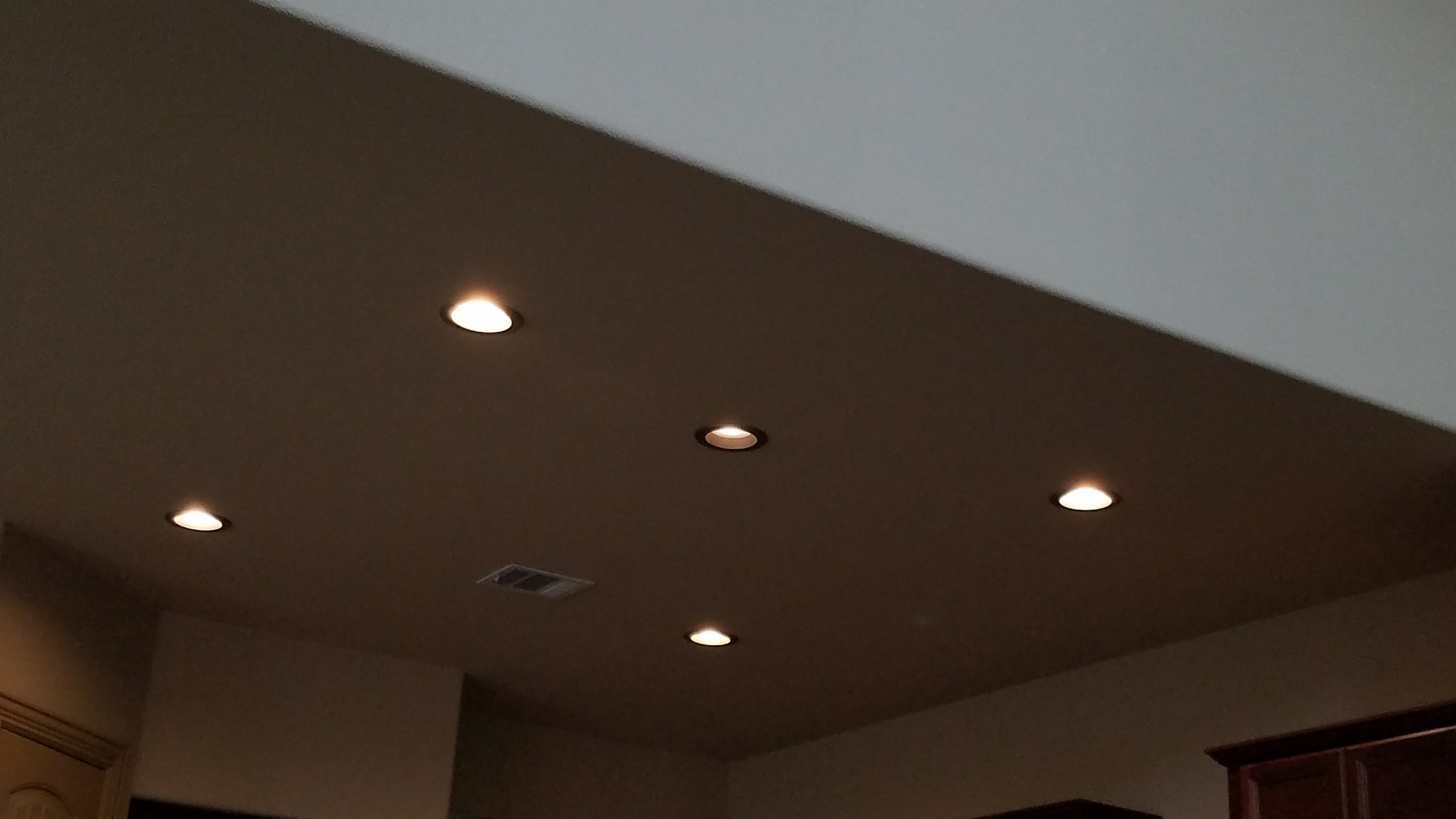

Ihappen to have 4 LED 1000 lumens can lights in my kitchen plus an identical can light for my sink. Given I wanted all of my kitchen lights on (what a pain to reach under the sink to turn on my sink light each time!) and I could not install a Leviton wall dimmer under the sink as there was no neutral, I resorted to using a Fibaro Dimmer 2 inside the sink can light itself. Then I programmed a smartapp to turn on my sink light when the kitchen light goes on, and of course also match my dimmer settings.
The point I am never getting to is that 1% light output on the Fibaro Dimmer 2 is much dimmer than the output on the identical lights controlled by the Leviton wall dimmer. There indeed seems to be a difference in dimmer performance. I will add pictures as soon as i can but with the naked eye the difference is pretty obvious and may help @d_sly achieve his goal.
Edit: Picture below doesn’t really show the real difference as the camera blows out the lights. They are all set to 1% but only the middle light is controlled by the Fibaro Dimmer 2 which by the way is a very impressive and customizable device.
This other one may show the difference a bit more.
