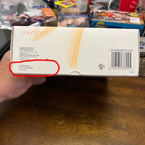

They are Gardenspot mini RGB
Here is pics of box
And front
Gateway
I know this will seem like nitpicking, but the first rule of home automation is “the model number matters.”
Is this yours?
Not nit picky at all. You needed to know full info. Looks like top FCC Id is same but different. Bottom. Here is what I have will send second reply for gateway since I can only attach 1 image being new.
Gateway
Excellent.
OK, the good news is that, although you can’t use the bridge device anymore since they shut down their cloud, the gardenspots themselves in that model are Zigbee devices, and you will be able to pair them directly with your smartthings hub. And then you will be able to control them through the smartthings app.

Mariano’s Zigbee Light Multifunction Mc driver support Lightify since edge drivers were announced (more than 2 years ago). They were one of the first devices added to his driver
Yes, that’s the same one I linked to in post #9 above. :sunglasses:
