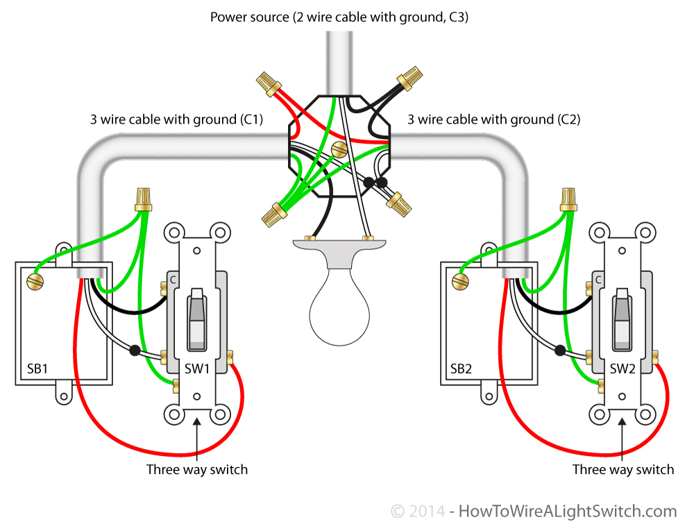

What you are missing at the switch boxes is a neutral wire. The Leviton requires a neutral wire at the switches to operate. Here’s a recent post similar to your setup.
