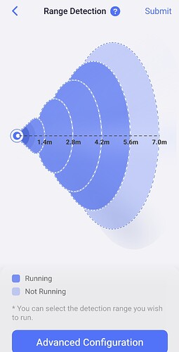

It doesn’t have the fancy zones and mapping features of the Aqara presence sensor but instead presents a status of motion or no motion. I’m happy with that if it is reliable though and detects people sitting without turning out lights.

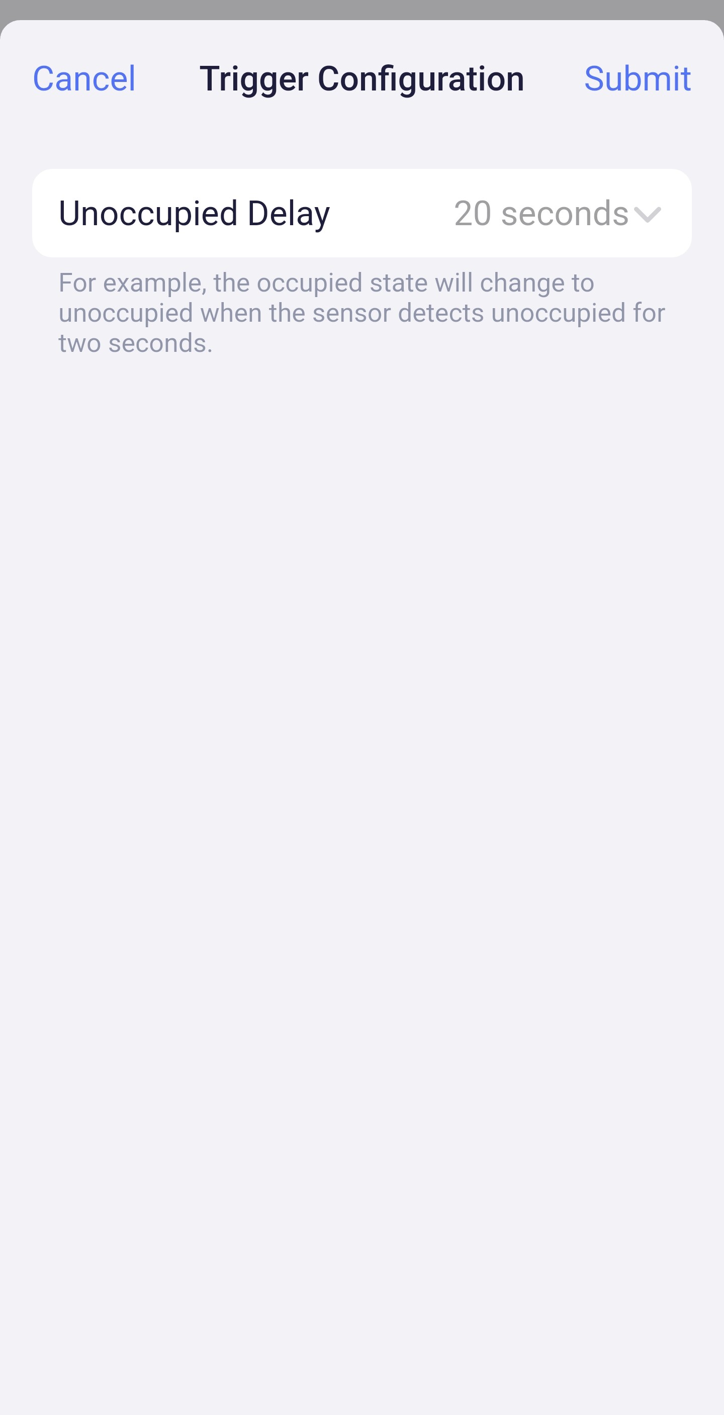

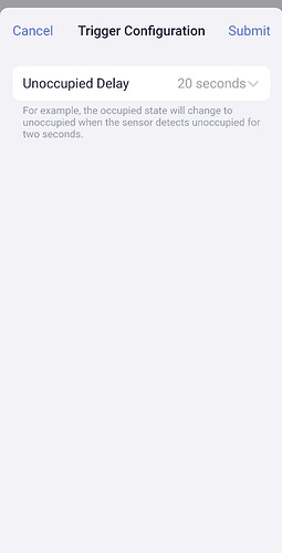

The lowest dwell time is 20 seconds. There’s no option in the Lafaer app for firmware updates,so hoping that will come via SmartThings. Here are some screenshots.
If anyone has any questions I’ll try and answer them. I’ll report back later with how it performs. The routines I have with it one trigger at night when it’s dark, so I’ll not know till I’ve had a few days to assess it.
