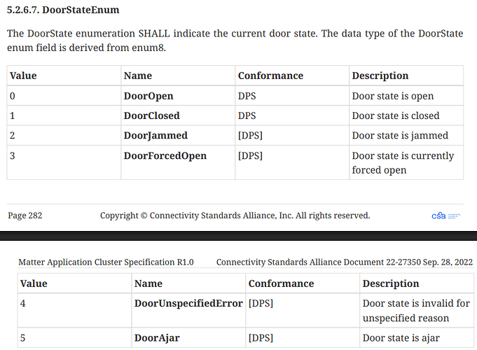

Hi, @Andreas_Roedl
I found this in the Matter Cluster Specification. Is that the “door state” you’re discussing here?
In the case of your device, would that be connected through a manufacturer-specific or a generic fingerprint?
I’m asking because I’m not sure if every device supports this cluster and if yours is part of the certified ones I can present the case for the engineering team.
Having the model and brand would also help to have a better reference.
Yes, that’s the correct spec. It’s a Nuki Ultra lock and so far the only Matter Lock that has this Matter feature. I’m in touch with someone from Aqara to support the DoorState in the U200 Lite - sounds like they simply forgot that there’s something like that in the Matter specs.
The Nuki fingerprints are in the “new-matter-lock” as you know.
What’s really missing is a fitting capability. Otherwise I would have submitted a PR to at least raise some awareness. As you can see, it’s just an additional profile and a few lines added, not deleted or modified.
Interestingly, the Nuki Ultra uses a Bluetooth contact sensor that is connected to the lock and the U200 Lite uses an internal gyroscope.
Yes, but that’s using an alternative capability, I was going to check if we could make a request to create one that has those possible Enums. (this can take longer)
But just to be clear, you’re request for now is to “contactSensor” instead, correct?
I’ve only used the contactSensor, because there is no doorState capability yet. And I wouldn’t recommend the contactSensor, because it is a binary state and every other state would be missing.
Implementing the DoorState without a matching enum capability would be a bad idea. You can discuss it internally how such a capability should look like.
So my request is to create a DoorState capability and the implementation of the Matter DoorState feature in the Matter lock driver.

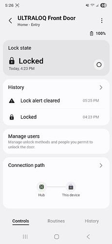

Just wanted to let you know that your driver works perfectly. I was having issues with the ST official matter lock driver and my aqara U100, I tryed everything but the lock didn’t report it state to ST.
I changed to your driver and it worked first try. Thank you very much.
I am using this for an ultraloq matter lock. Thank you very much I love how it reports the built-in contact sensor status. However the tile for contact sensor replaced the tile for manage users. It’s weird this matter lock does not report to smart lock like my old Z-Wave, and has a built-in user management system just for specifically that lock. I don’t really like it because I’d love to use this lock to replace a bunch, but I don’t feel like programming 20 codes in each fuck individually. Off the tangent of Smart Lock access, is there a way that the user management tile can be a part of your drive r too that shows contact status? I’m trying to learn the edge drivers developer thing but not having much luck.
I was looking into this just today. This driver is based on a version of the stock driver from before they introduced modular profiles. If I find the time this week, I’ll add the door state feature to the current modular driver. In the meantime, you should use the stock driver, if you want user management.

Can you please provide a screenshot from the device card with the user management? I’d also need the manufacturer/model IDs of your lock. You can find them in the information screen (three dots).
Certainly!
(attachments)

Added – DoorState support in modular profiles
  • Added DoorState → contactSensor mapping for the DoorLock cluster:
    • Subscribes to DoorLock.attributes.DoorState when appropriate.
    • Maps the Matter enum values to contactSensor events:
      • DOOR_OPEN, DOOR_AJAR, DOOR_JAMMED, DOOR_FORCED_OPEN, DOOR_UNSPECIFIED_ERRORcontact: open
      • DOOR_CLOSEDcontact: closed.
