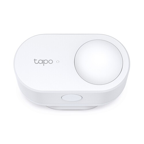

Tapo T150 Battery Human Presence Sensor
Lafaer LWR01 Battery Matter Human Presence Sensor
Like the Tapo T150 or Aqara FP300 (both M/T).

The Tapo T150’s battery is said to last three years.
They said up to 3 years, but that’s still pre-release discussion, right? Can you buy that one anywhere yet?
We’ve seen several devices which promised two or three year battery life in their pre-release descriptions, but once they were available in the field, typical use had a battery life of about six months. ![]()
But we’ll see.
As always: I’ll get one as soon as it’s available and report back to you.
Everything else is speculation…

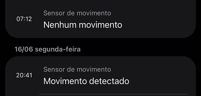

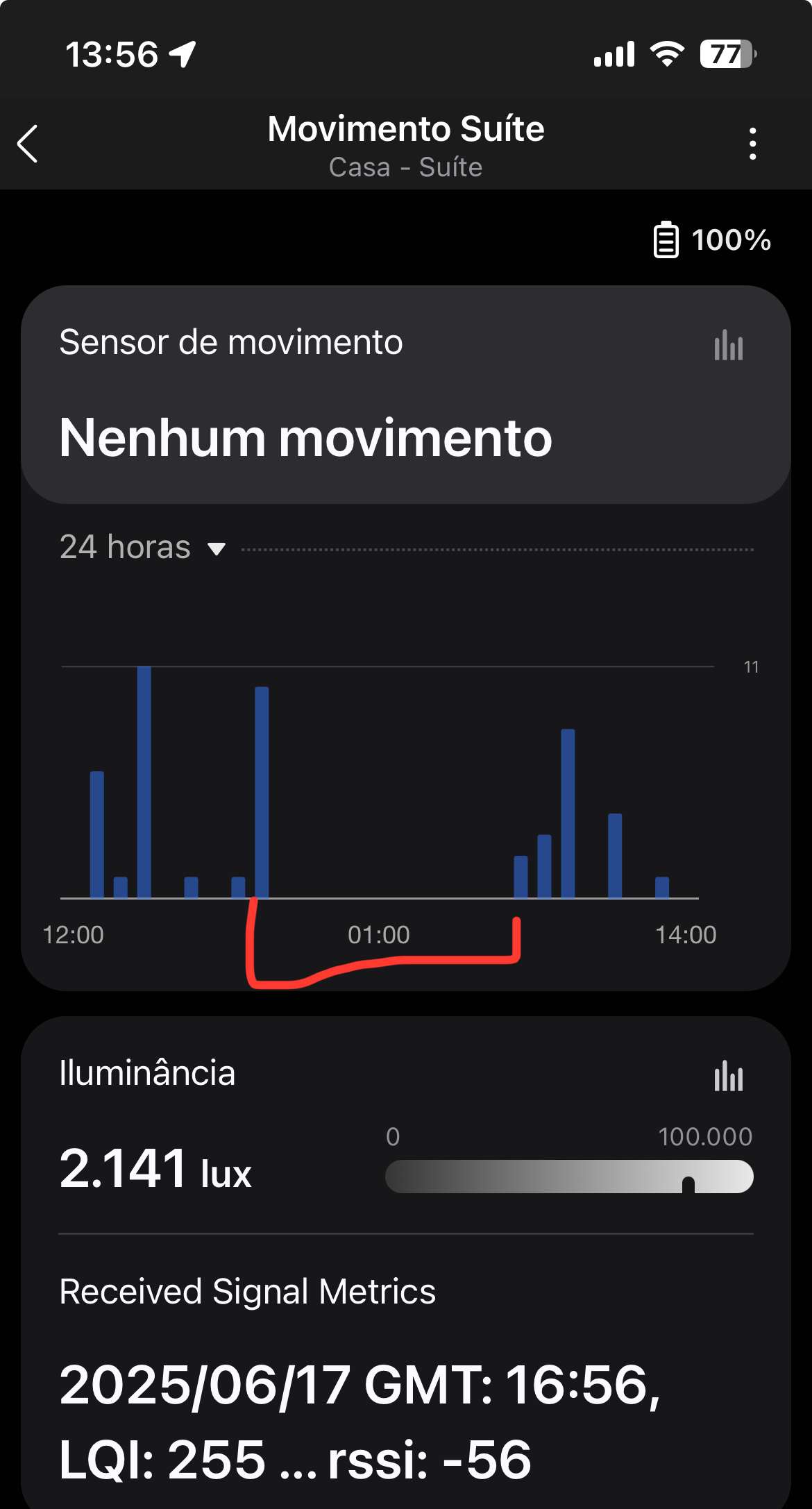

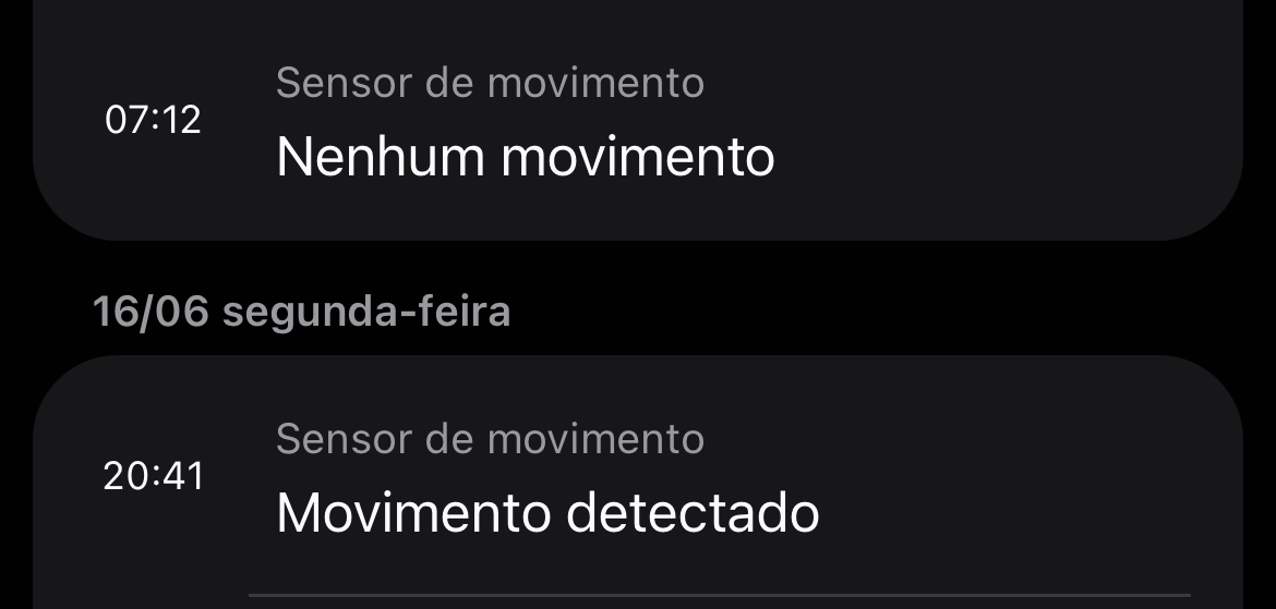

This is a sensor in my bedroom:
The sensor stayed as “movement detected” all the time that has someone sleeping in the room, and don’t get triggered again until there is no one:
