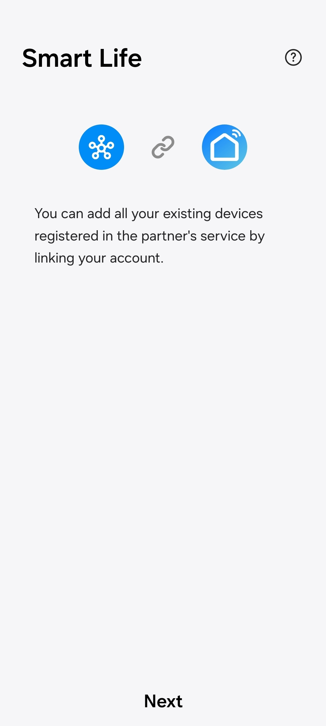

I have tried and it tells me “The page you are looking for can’t be found”. Same thing happens when I try to link a Tuya hub or account to ST. Anyone knows anything about it, please? Thanks in advance.
I just set up a Test location and linked my SmartThings and SmartLife accounts with no problems.
In the SmartThings app go to + sign (at top of on Favorites or Devices pages), select Add Device, select Partner Devices, select SmartLife and then follow the prompts.
