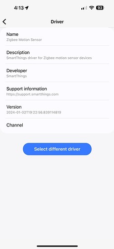

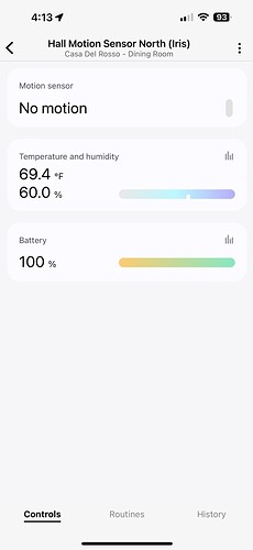

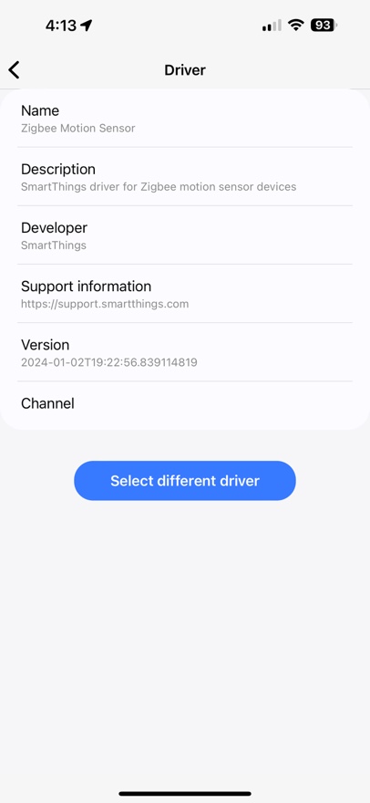

Do your Iris IL07 report temperature?
Yes mine do.
Yes, mine report temperature, and they are using the stock Zigbee motion sensor driver.

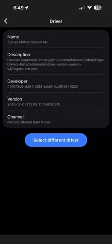

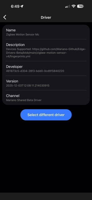

My Iris IL07 tends to eat batteries quickly. Has anyone found a way to change reporting time? Or another driver?
I have been using the stock driver and I also have noticed the battery life seems to be a lot shorter that is used to be. So today I just started a test using Mariano Shared Beta Driver in a couple of sensors and the stock driver in a few others. With this driver you can change the motion sensor interval reporting. I will leave it stock at 300 sec. I will see if it gets longer battery life.
I have tried all of that already. Stock driver, Mariano’s driver, different reporting intervals etc. Batteries in most of my devices used to last well over a year and now I have to replace them every 3 or 4 months. its gotten progressively worse as they have rolled out the later firmware upgrades!
I think mine lasts about a month. I just changed to the Mariano driver. I changed the Temperature Report interval to 15 (minutes) and the Temperature Reportable Change to 200 (2 degrees). I will see if it helps. I left the Motion Sensor at the default 300.
