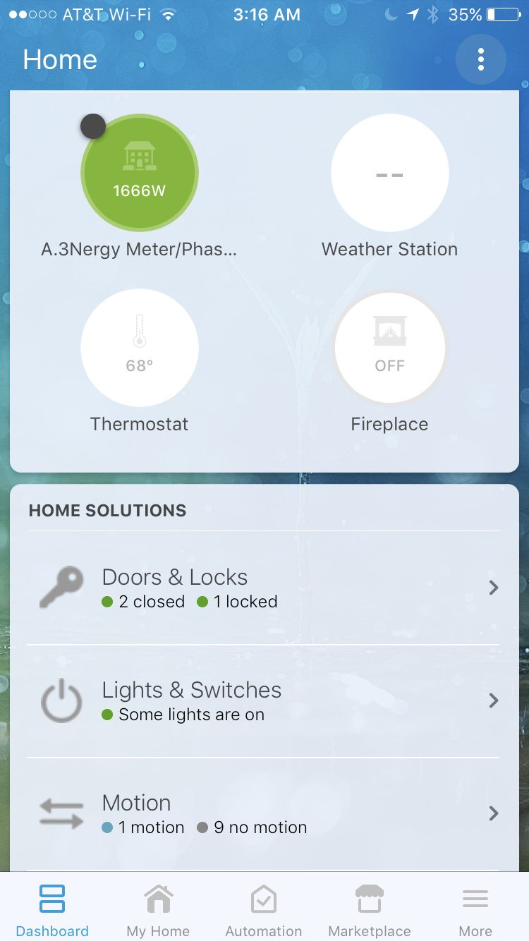

How do you get that overview of doors, lights and motion sensors on your dashboard? I can only get SHM, smartlocks and favorites
You have to be an OG from before the V2 hub came out and then never have deleted those apps. They aren’t available to install anymore.
