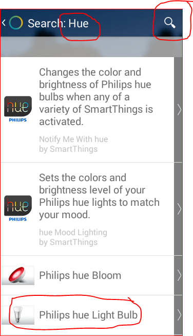

It’s under :heavy_plus_sign:SmartSetup” - “Things” - “Light Bulbs” - “Philips Hue Light Bulb”. Not entirely obvious, I know. It should appear under Labs SmartApps, but does not.
Alternative Way…
Tap :heavy_plus_sign:, tap the Search Icon :mag: on the upper right.
Input: Hue
Select: Philips hue Light Bulb
Ahhh, that fixed it. I seen that option was terrified it was going to add the bulb directly to the ST hub, without the bridge, which i didnt want to do. Thank you for help! We are back up and running now.
