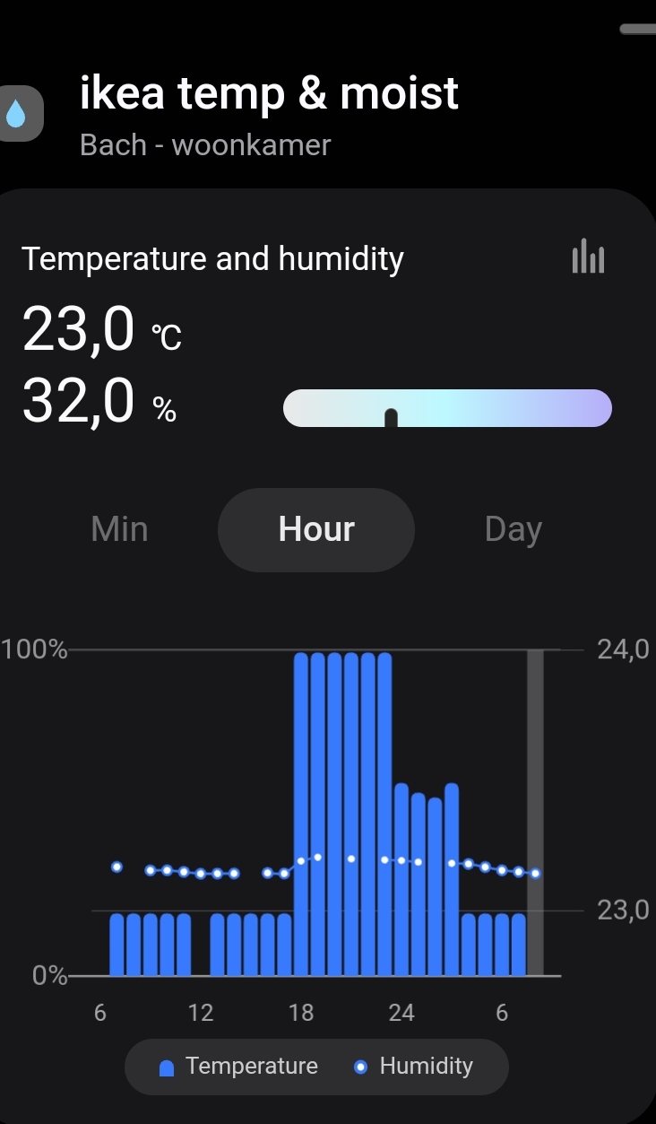

Can anyone tell me how often it reports data back to the SmartThings hub?
I use zigbee battery powered temperature sensors as virtual thermostats in my kids bedrooms and they are way too unreliable. They randomly report data between 20 minutes and 4 hours. That’s way too unreliable for my use case I need something that will report about every 15 minutes.
Do you read value changes in history?
Real updates you can see from here in App.
In this picture, the sensor sends a value every ten minutes.

My sensors are of a different type. I just wanted to clarify how to interpret the data.
Looks pretty solid to me.
My sensors are Aqara ones and the graphs are missing up to 2/3 of the blue lines (per hour, forget about per minute, there’s no way), while there are a few more readings in history, but still far from anough.
I have MYSA thermostats as well and since they’re connected (see not battery powered) and Wifi, the readings are solids and not missing a line even in the minutes graph.
Looking at your screen captures, it looks pretty reliable. It’s a bit expensive, but I’m having such a hard time finding a good alternative to zigbee battery powered devices…
Thanks for the screen caps!
