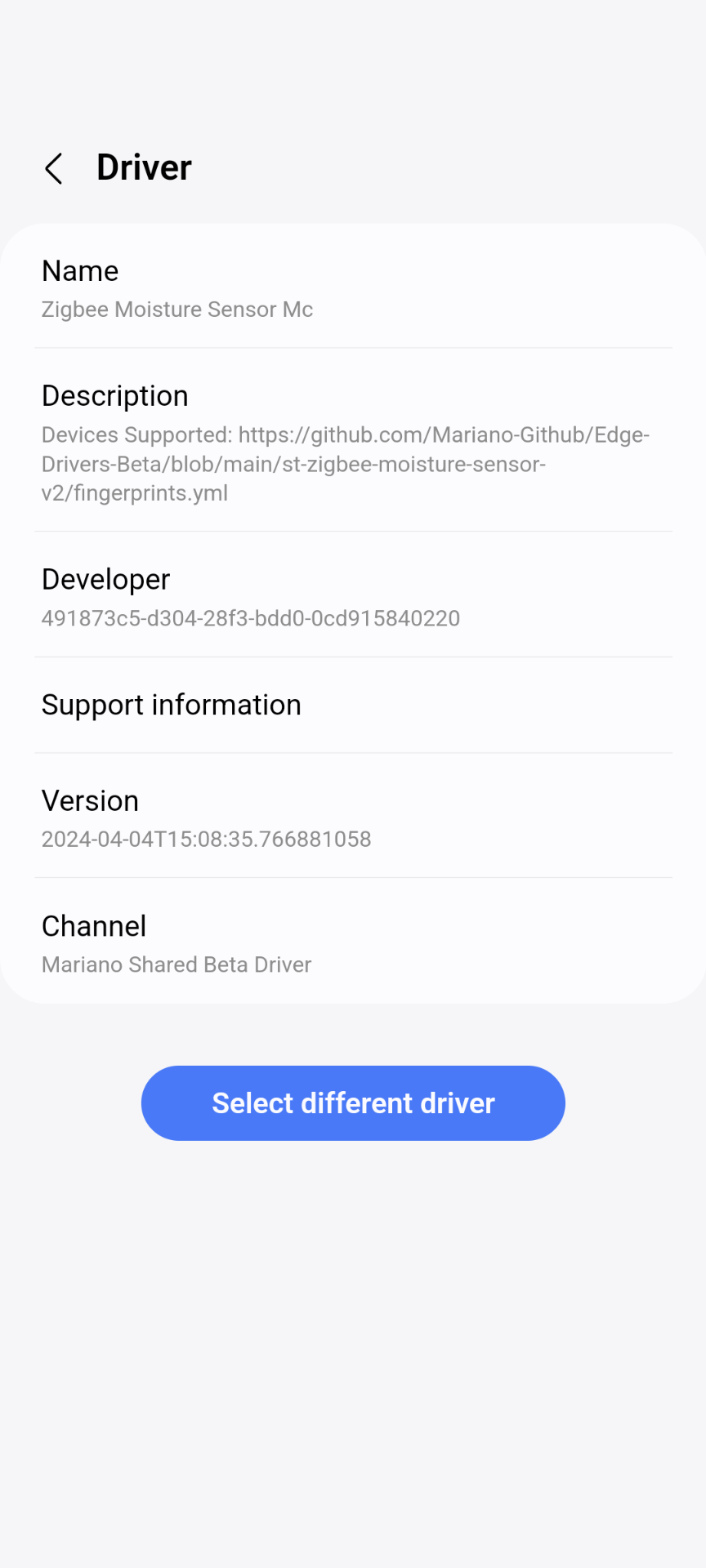

Ok, I’ve connected it with this driver but just get this message : Waiting ZigBee Message
You have to simulate Water Detected situation. Put sensor probe to water then sensor is sending message Wet.

Have you installed this driver to your Hub?
I managed to connect but it constantly connects and disconnected and doesn’t alarm on Smartthings. Not good at all
Yes, have installed it but can’t get Smartthings to even find a unit to add. Don’t know if I’m doing something wrong when trying to add it. Trying through my app and doing a factory reset pressing 4 times until it blinks.

In order for the device to configure correctly the periodic reports, it is essential to reset it and pair it directly with the Mc driver.
If you made a driver change from zigbee thing, then the device does not configure correctly and does not send reports correctly
Ok, I finally got mine working, when I looked I still had a device lurking from my initial attempt to connect it as a ZigBee moisture sensor (not allocated to a room so I missed it). After I deleted that and all other instances of the water sensor I went through the pairing from scratch, Smartthings saw it as the correct IKEA device with the driver and it now works faultlessly. Actually a brilliant little sensor at a great price.
