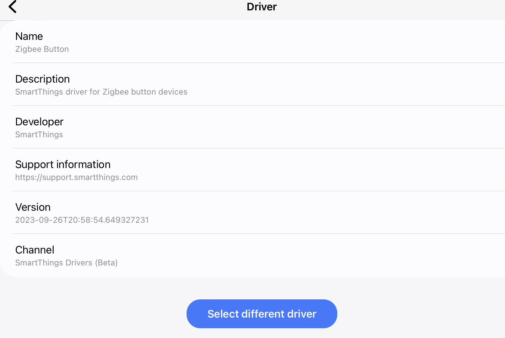

I’ve added and deleted it from my Aeotec hub many times. I’ve tried a few different drivers but no matter what it doesn’t register any button presses. It says it is connected but it always says ‘This device hasn’t updated all of us information yet. Check again later.’

When I got home today it finally isn’t saying it hasn’t updated it’s info yet, and now the battery status shows, but but presses still don’t register at all. (Although strangely it shows 44% using one driver and 87% using a different one)

Do you still have the button around? My guess is the firmware is actually recent, IKEA broke a few drivers when it changed both the bindings needed and the way to report battery level.
Out of curiosity, does the big power button work? I could understand why the others don’t work. Do you know the firmware version?
Edit: Indeed, firmware 24.x changed it all. I believe the stock SmartThings drivers are not compatible with the updated firmware versions of the buttons. They don’t account for the battery reporting or the bindings.
