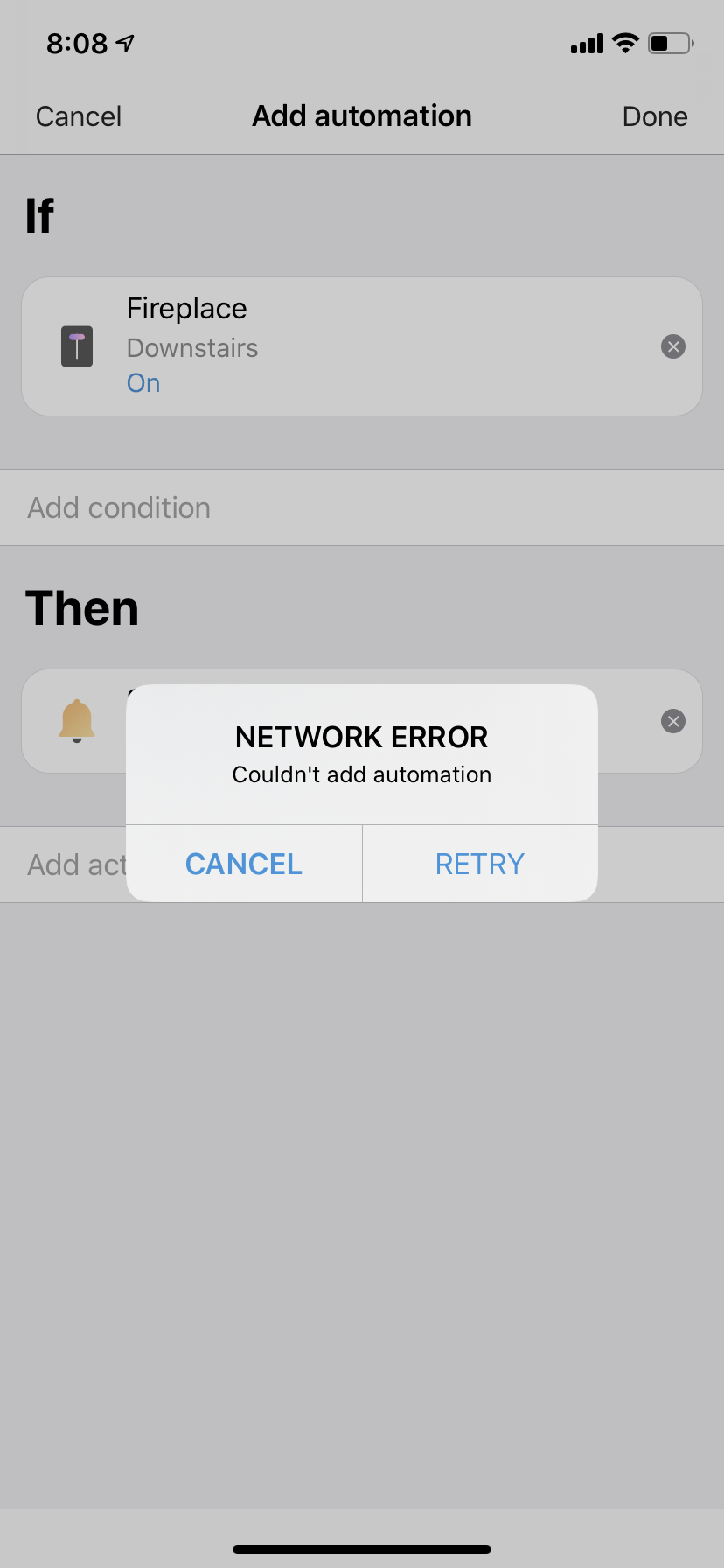

Adding to the errors:
The saga continues…
