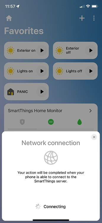

As someone who’s been involved with smartthings since literally the very beginning (Kickstarter backer), I’m getting to the point that I just want to give up. I’m so sick of trying to use the app and have to hit a button… wait 45 seconds (or so) for it to say: A network error occurred then try again, and again, and again before maybe 4-6 minutes later it decides to work. (This is whether I’m on wifi or mobile data, whether I’m standing 10 feet from my hub or miles away.)

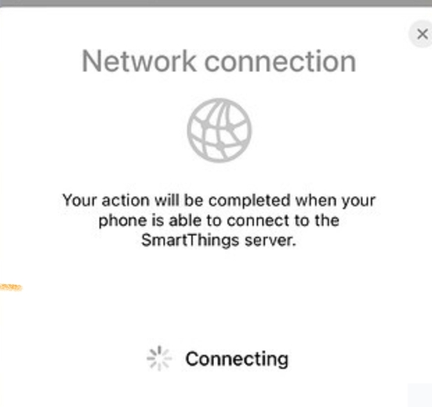

For the app, there is not a solution. This began in June for me, and I have submitted 6-7 cases without resolution. In other threads you will see it happens to many others as well. I do not believe it to be a genuine “network error” because other things (Scenes, STHM) are controllable instantly when you open the app. It occurs with individual device control, and probably has to do with the device control module updating status.

I have never ever seen this error. Are you iOS?
Yes, iOS. It happens consistently within the first couple of minutes of first opening the app or when the app is brought to the foreground after being in the background for a while. If you are on iOS and NOT experiencing it, I’d love to compare configuration to see if there is something that stands out as different between us that might explain it. This has been happening since one of the app updates in June (the error message is a new addition, but the behavior of inability to control devices is the same).
yeah, it’s a very poorly worded “error”. It the same problem with devices taking forever to refresh on iOS, it jsst now has a poorly worded “error” over it that causes even more confusion.
