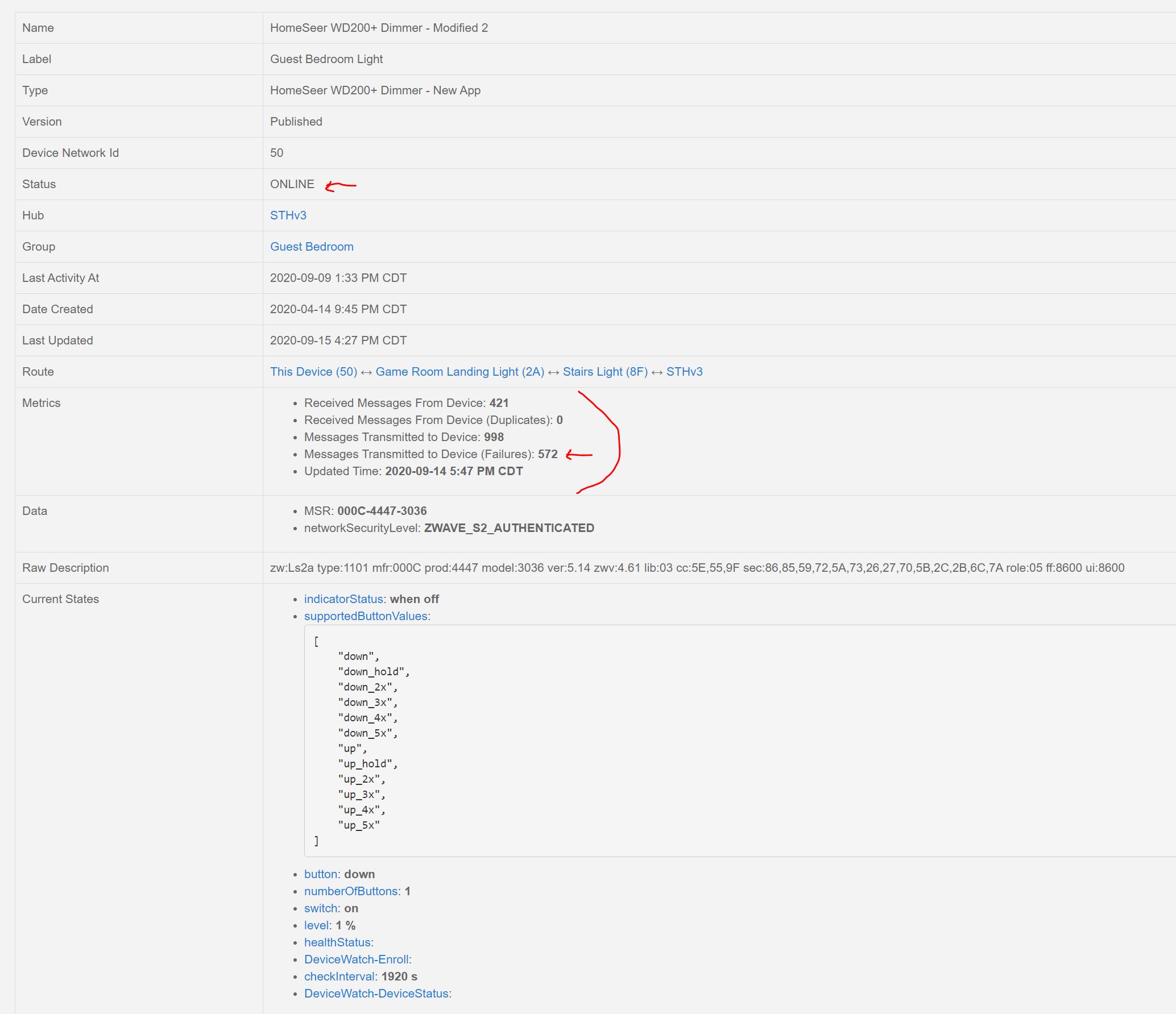

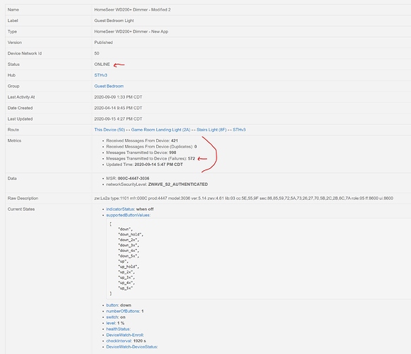

Is anyone having issues with zwave devices being reported as offline on and off all the time? I believe it is some issue on my system but wanted to be sure I was the only one seeing this.
EDIT: Device shows as offline, and goes offline either when trying to interact with it, or shortly after while I am still looking at the screen frustrated. In other cases, I press on/off and it just twirls forever with the device either not working at all, or doing so with extreme delay. It often also flashes the annoying network error at me.
Edit2: The device shows ONLINE now but is still completely unresponsive. The IDE was showing it with a last activity date of 6 days ago… that is also when this device last froze on me and seemingly returned to life with a power cycle, but now it would seem local control came back while the connection to the hub died !?! Soooooo why is it marked as ONLINE ??

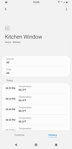

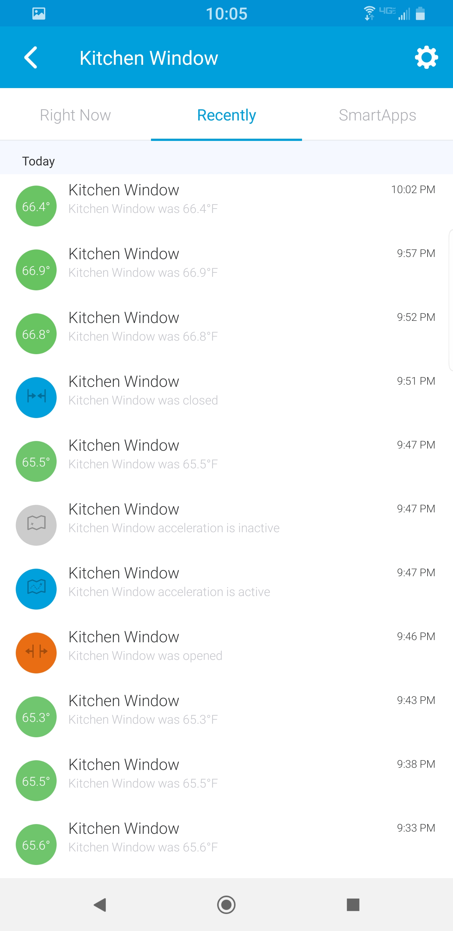

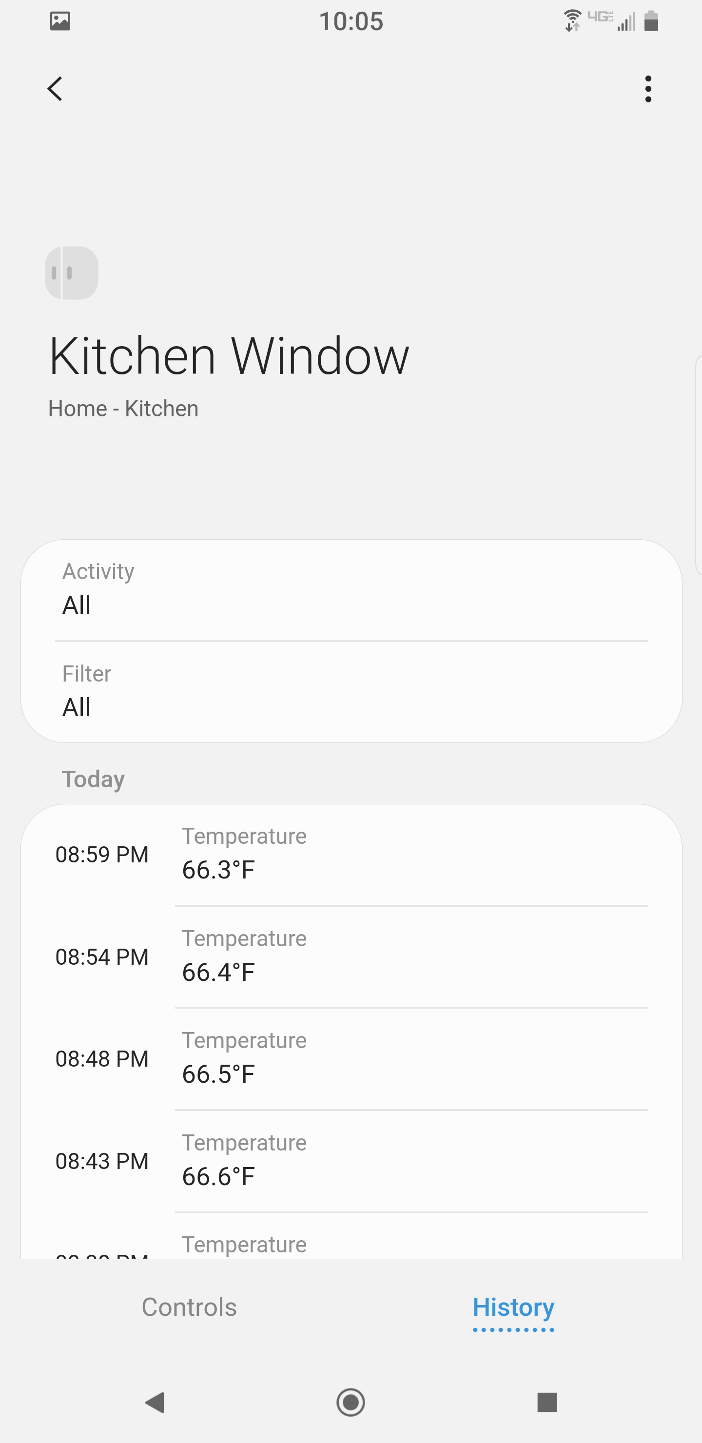

Several brands of contact sensors are not recording open/close in the new app after the beta update, just temperature and even that is inconsistent.
Interestingly, they are recording these events in the Classic App. Same sensor in both apps screenshots attached.
I will DM you about this issue.
