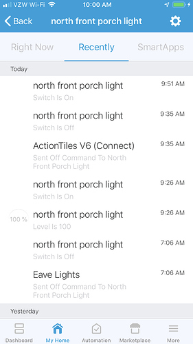

Here’s recent activity from the ST app. It is switching on anytime the doorbell detects motion. I have been manually turning it off.
Your piston isn’t turning the lights on. Check smart lighting for anything still there. What is showing in the smartapps tab of one of lights?
