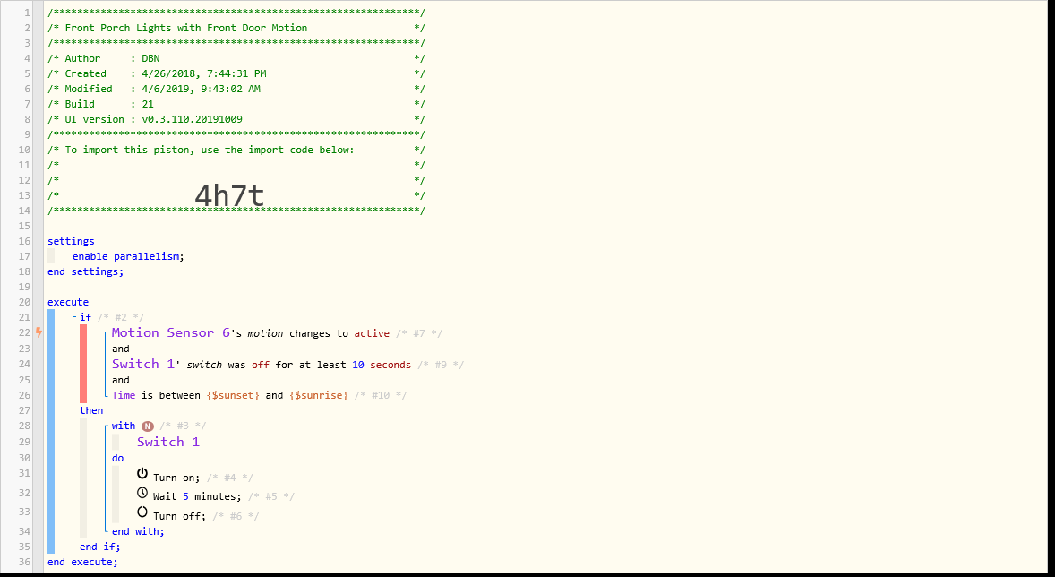

@ThebigO use the below piston in webcore and it should get you up and working without the looping.
