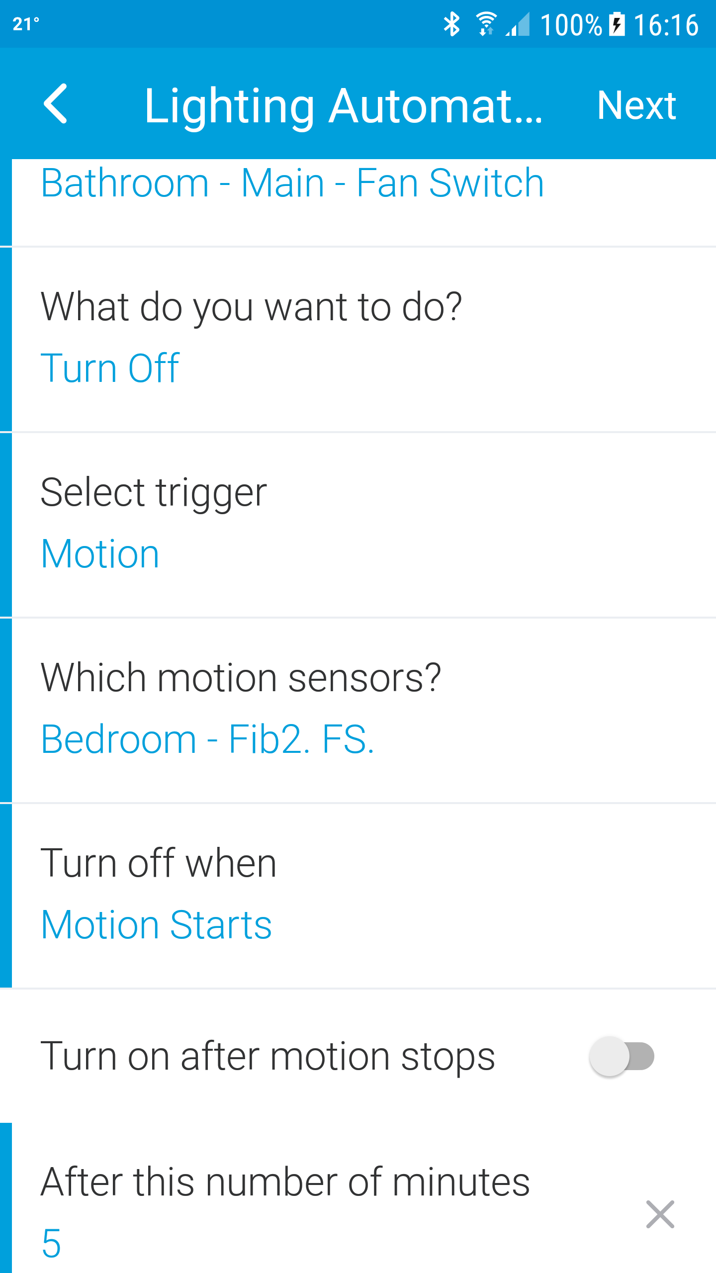

Have you looked at Smart Lighting?
It is a lutron caseta dimmer control for my kitchen high hats over a counter.
Use Smart Lighting.
In the mobile app go to the Marketplace tab.
Then SmartApps.
Now select Smart Lighting.
You just go through the menus.
