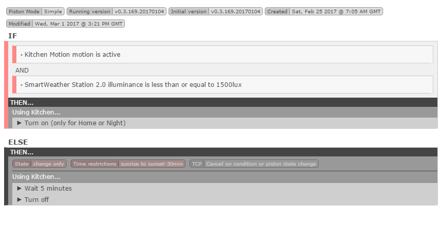

You will have an issue though if it is not between sunset and sunrise and the light gets turned on. It will not turn off. You might want to get rid of that restriction.
@bobbles thanks for the help. I will try this. I donât want the light to automatically turn off between sunset and sunrise. I want to handle this manually.
@bobbles, I have now changed the piston based on your inputs. I have changed CoRE to expert mode, but couldnât find anything under Advance options to âDisable command optimisationâ. Can you please help me where this exactly will be? I looked under each condition screen and the screen which shows all the groups. Below is how the piston looks now.

Take out the change only in the else.
This wonât make a difference but isnât needed.
Go into the dashboard and watch the piston.
Does it ever go blue (true) when you either have motion (change the lux to greater than for testing if it is above the value set) or turn the light on.
EDIT: Check to make sure mode is home.
