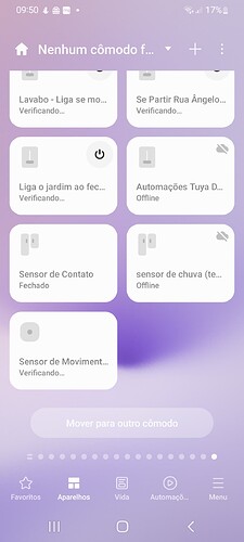

Hello! Just tried! It keep saying “verifying”:

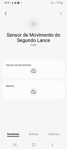

Then when clicking on the device it appears this way:
This is the proof that i selected the proper driver right.
I set up 2 automations (turn on and turn off based on motion detection or absence of a bulb for testing). Nothing happened…

Can you install zigbee thing Mc from my channel and make a driver change to see what clusters and endpoints it shows?
Here it goes:
Hi @Noe_Bailly
Smartlighting does not seem to discover the necessary clusters and therefore will not work with Smartthings.
