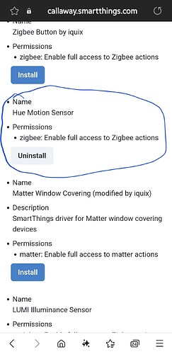

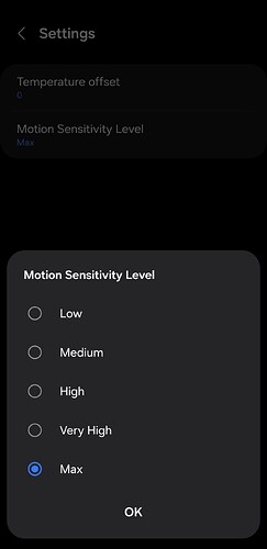

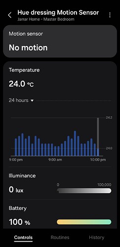

I will answer you as I already have this sensor, regarding connected directly to samsung hub with latest update the answer is NO, this update make the connection through philips hub, for me I don’t have philips hub as no added value will get, I connected the hue motion sensor directly to samsung hub but in this case you have to used the iqunix channel driver and you will get all the control of hue motion sensor…Please check the photo from my samsung hub…if you need any more clarification I will be happy to help you
