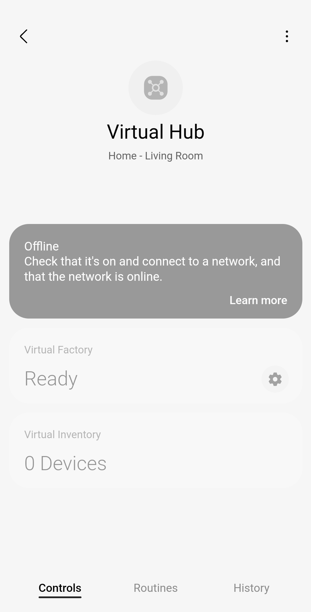

Unfortunately I can’t seem to get this working. The hub is picked up as a “virtual hub”,
but it connects with a different driver to “philips hue beta”.
All that’s there is a virtual device creator.
I’ve tried to change the edge driver to “philips hue beta”, but then it immediately goes offline.
Tried restarting the smartthings hub at various points but still can’t get it to work.
Ok, first things first, although the smartthings app allows you to change from one LAN edge driver to another, this usually breaks because you don’t get all the security information transferred over. To use a different edge Driver for a Philips hue hub (which is an LAN device) you’ll have to scan nearby to get it to pick up the new driver. And, yes, that may mean that the hub is listed twice as a device in your smartthings app. But that won’t hurt anything.
I’m not 100% sure, but it sounds like you might be trying to use the following custom edge Driver. If so, ask in that thread for help.
[ST Edge] Philips Hue LAN [BETA]
It was my bad! I assumed that when I got my new router I’d moved all the ethernet cables into that instead of my router/modem…I had not :man_facepalming:after I moved my smartthings hub into the same router as the hue hub it all worked flawlessly.
Ignore this nonsense…should have checked my ethernet cables!
