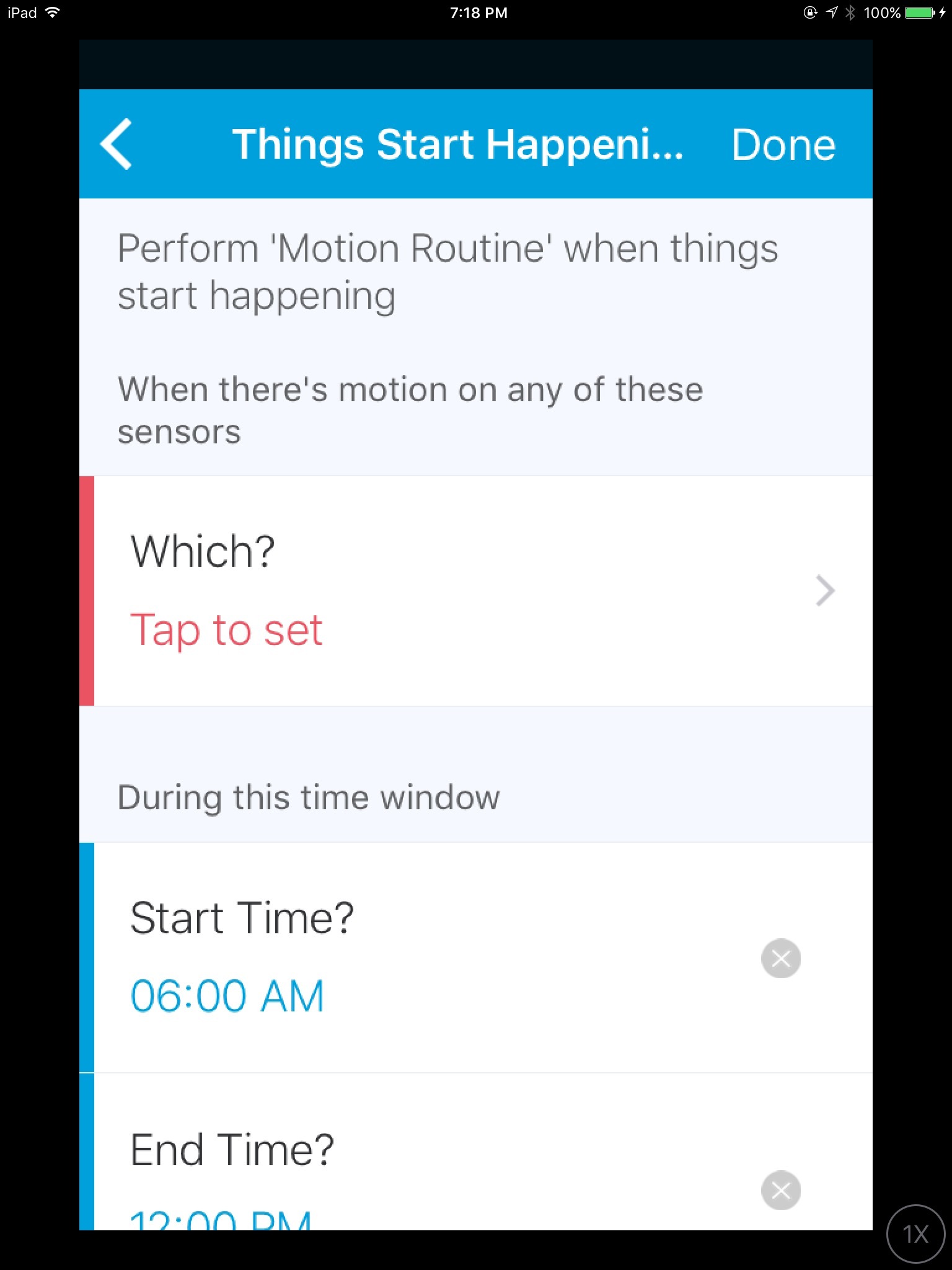

It’s a motion sensor, so it should be “when things start happening” or “motion detected” depending on the specific set up wizard you are using.
Door/window sensors are contact sensors and the option will be “when something opens” for those.
If you’re setting it up in a routine, it looks like this:
If you’re setting it up with the official smart lighting feature, it looks like this:

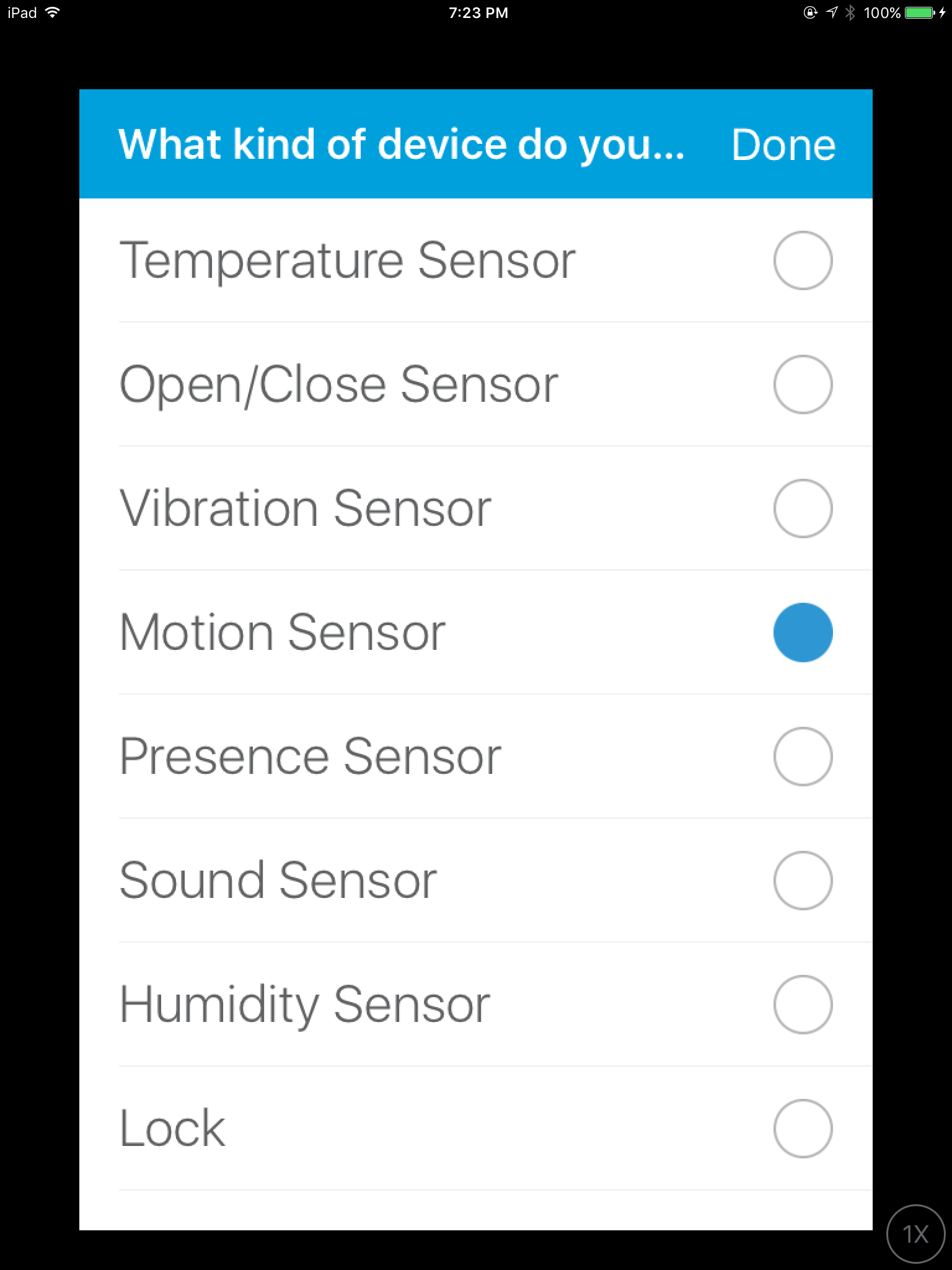

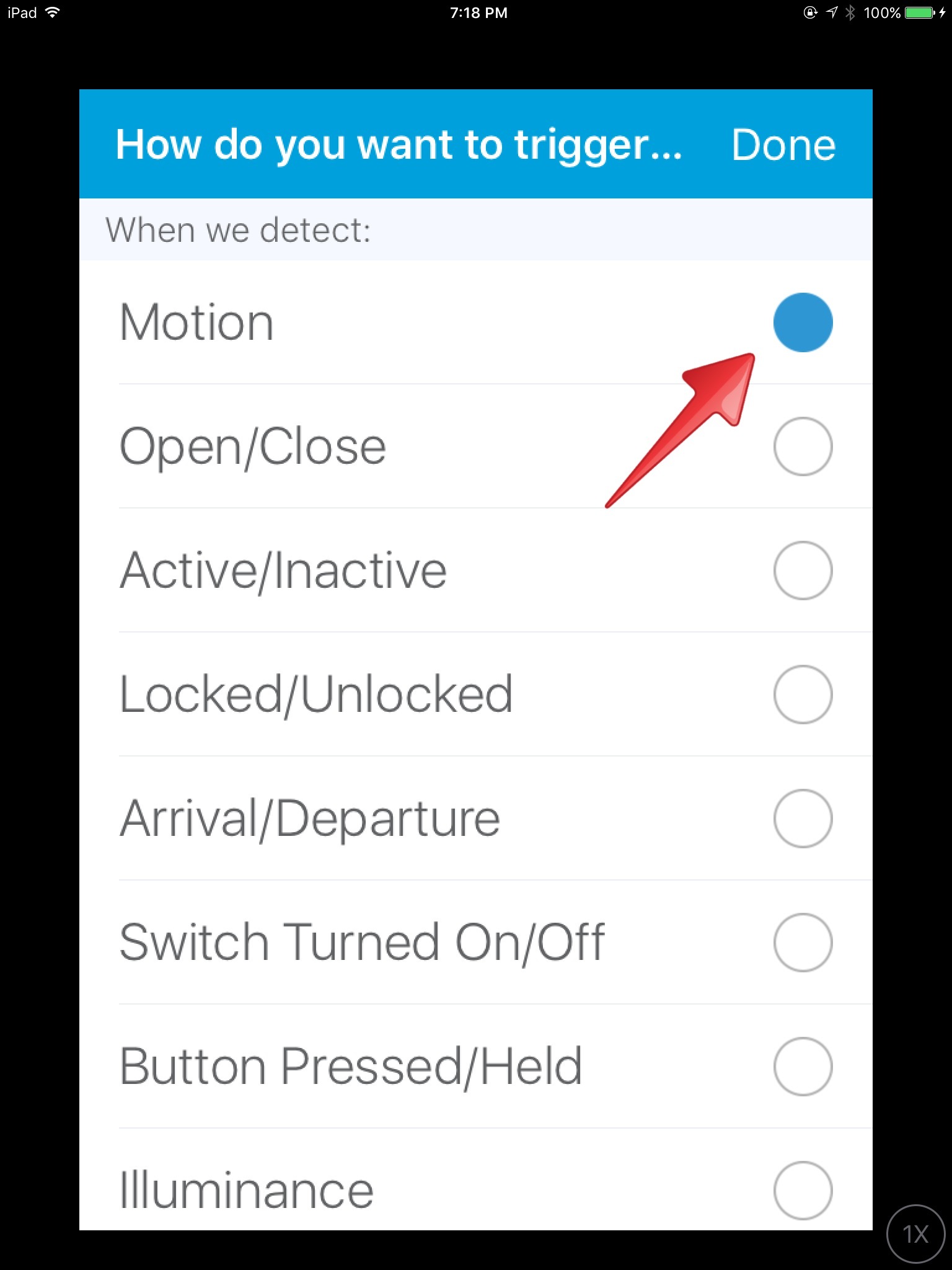

And if you’re setting up a custom alert in the smart home monitor feature, it looks like this,
And there are still other ways to create Motion sensor automations with still other formats.

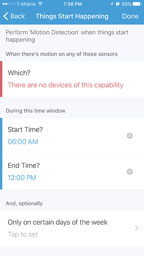

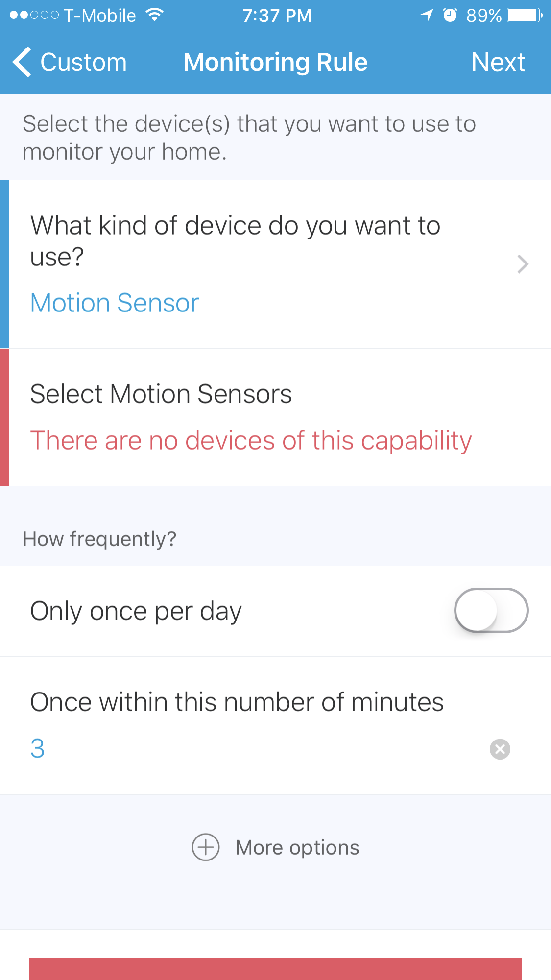

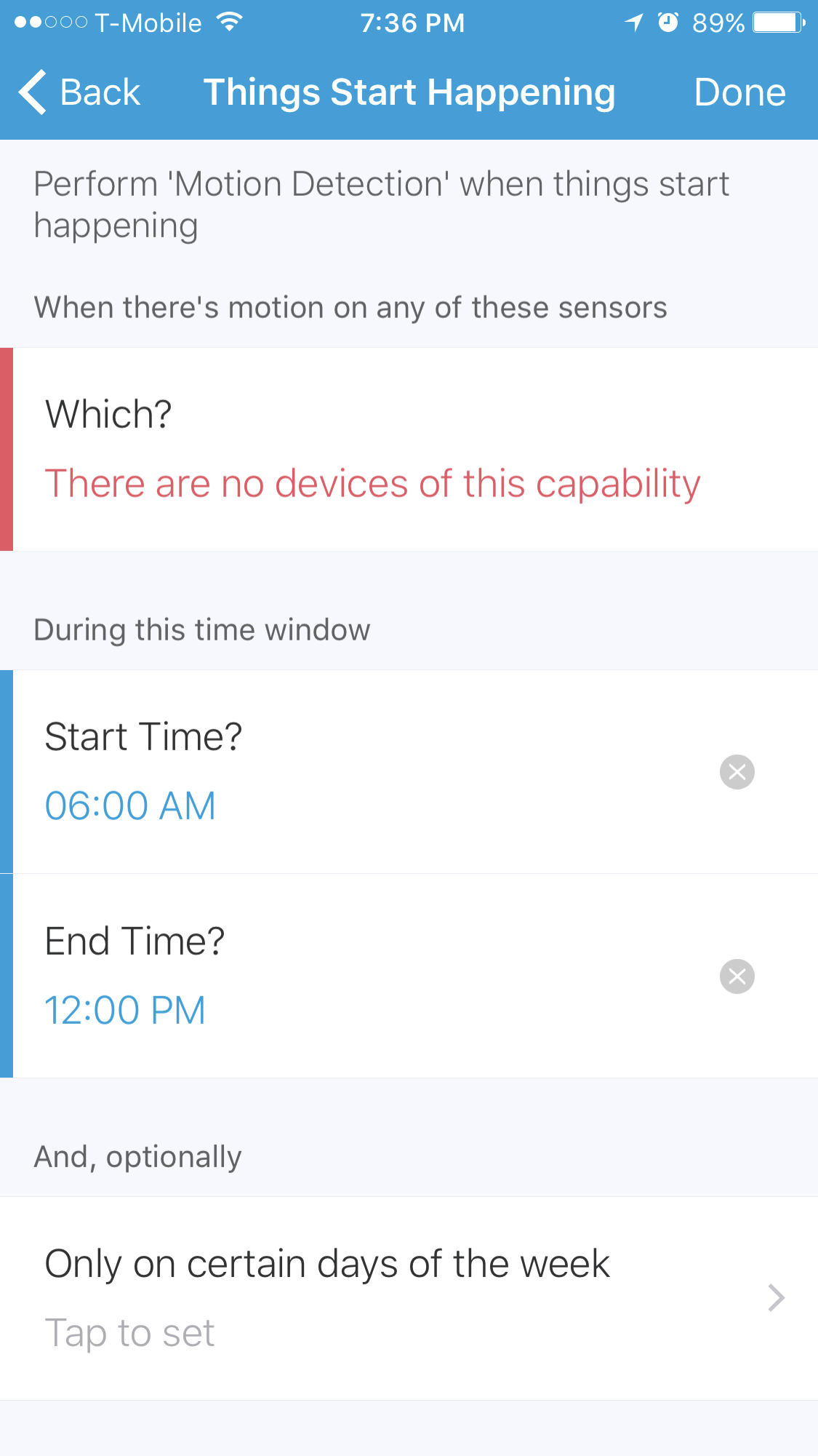

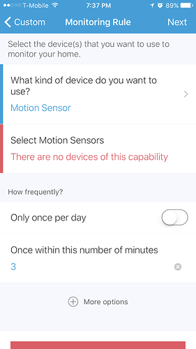

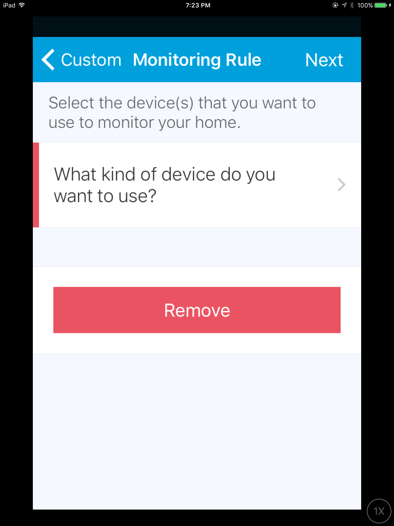

I just tried two configs, one from routines and one from my smart home custom configuration.
Here are my two screenshots:
Hmm. Just can’t seem to get my Zooz motion sensor to be recognized as a valid device, even though it appears just fine in my device list.
OK, it’s probably the device type handler that’s been assigned to that device, but I’m too tired to go into the details right now, so hopefully somebody else will be able to help.

Hi Oyjord,
Custom handler is not necessary for the sensor so if it seems like too much for your first ever device, you can just change the device type for the sensor.
Please follow these instructions:
  1. Log in to https://graph.api.smartthings.com/ (or to https://graph-na02-useast1.api.smartthings.com/ if you don’t see your devices using the first link) with the same login and password you use for your ST app
  2. Click on My Devices in the top menu
  3. Click on the Zooz sensor
  4. Scroll down to the bottom and click on the Edit button
  5. Go to Type and select Z-Wave Motion Sensor from the drop-down menu
  6. Click the Update button on the bottom of the page
Then press the Z-Wave button 4 times quickly (unlock-lock-unlock-lock) and leave the sensor next to the hub for at least few hours to ensure proper configuration.
It’s important to remember that the Z-Wave button needs to be locked (pressed-in) for the motion detector to be enabled. If the Z-Wave button is unlocked, the sensor turns into a tamper device instead and no longer detects motion.
