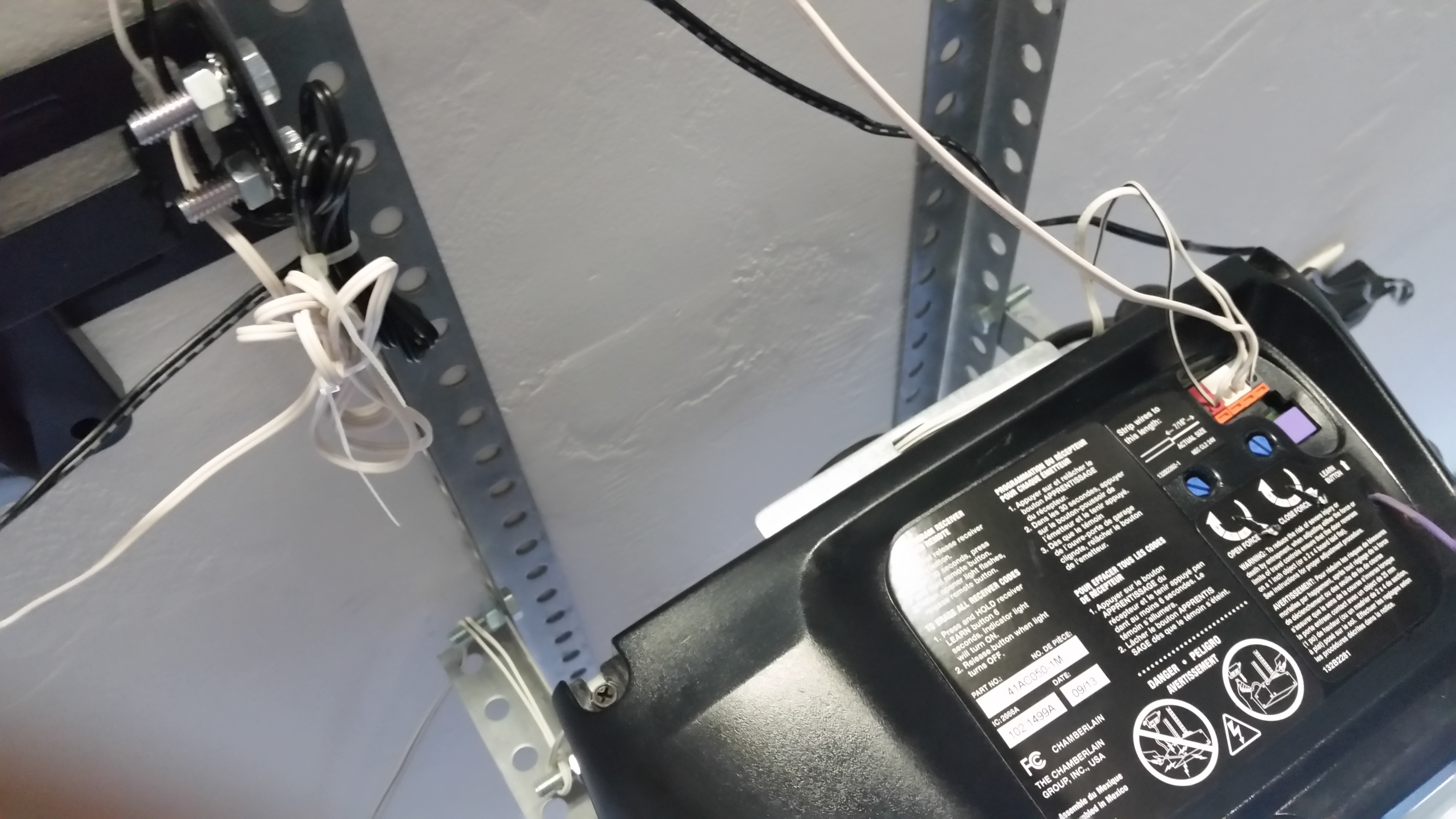

here is my set up - Liftmaster - the thicker cables in the center are the DC terminal post- 1 into red 1 into white
I did this with no soldering of anything … straight out of box integration.
Yes I’ve got my setup the same way. I can see however that your model
garage motor is different than mind. I’ll be trying the other method and
will let you know if it works.
