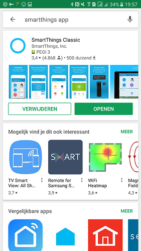

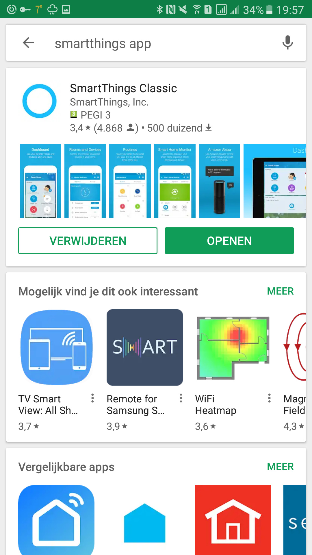

Use the old app SmartThings Classic app for all not supported things.
I have a SmartThings v2, you the v3!?
Try this app to add the Gledopto controller.
