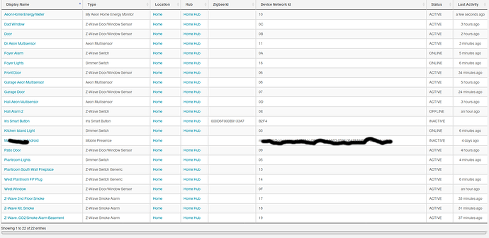

Here is the report generated and my listing of devices. Some number in the Zwave repair screen do not match up with the device listing, confused.
the item not working is the one showing no activity in the 2nd screen shot, Device ID #13
