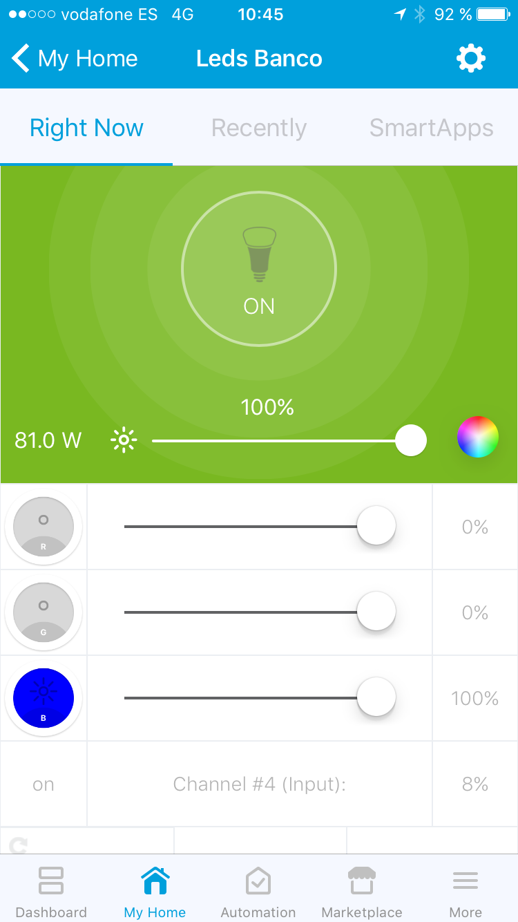

Is it normal that I see 11.2W power having the maximum brightness and all channels turned on?

12V 10A, so it should be 120W and the strip wattage is 96W. I guess I’m having a wattage drop…

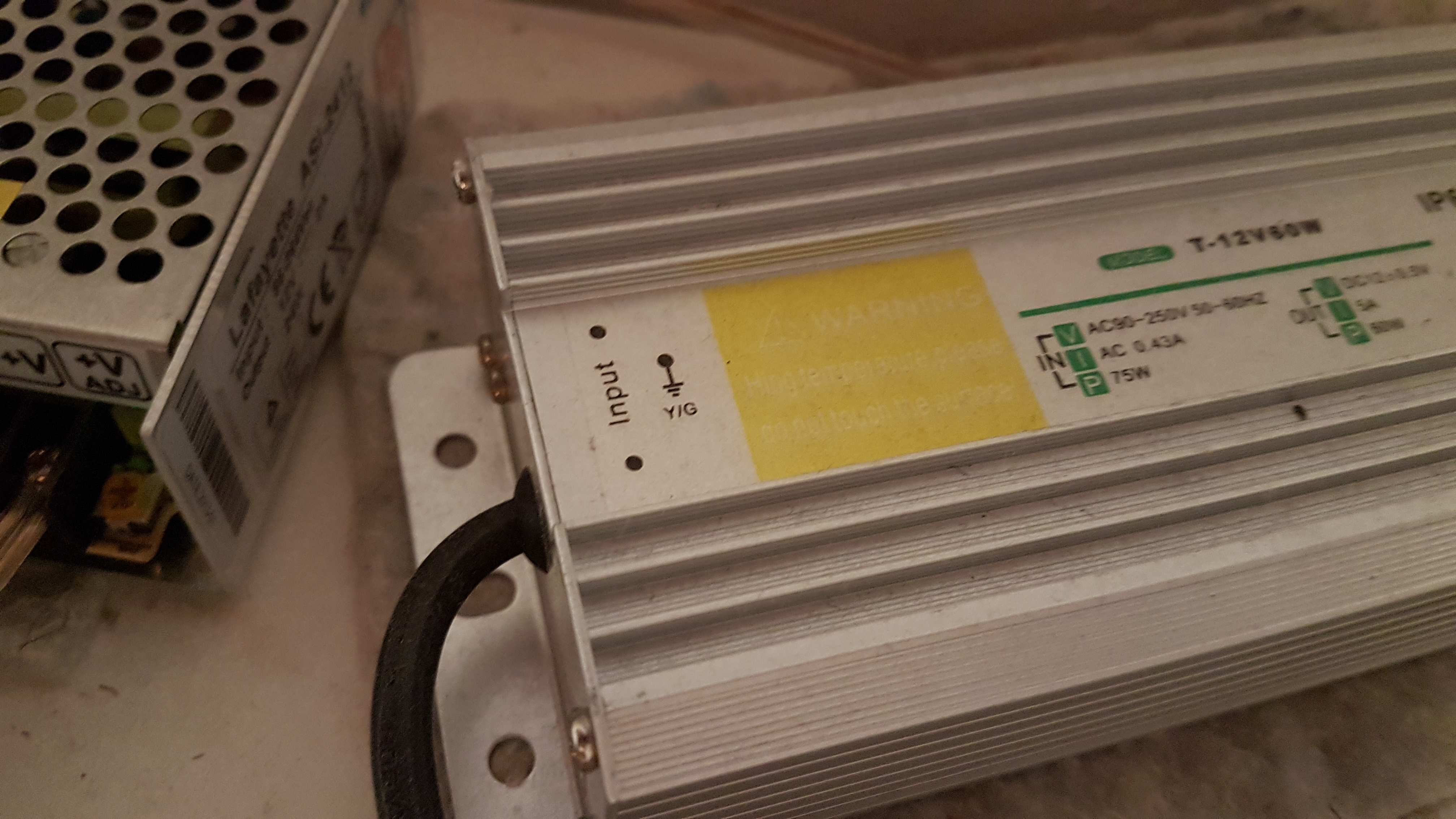

What kind of transformer are you using? I’ve had trouble with cheap Chinese transformers, that behave erratically. You could try a different one.

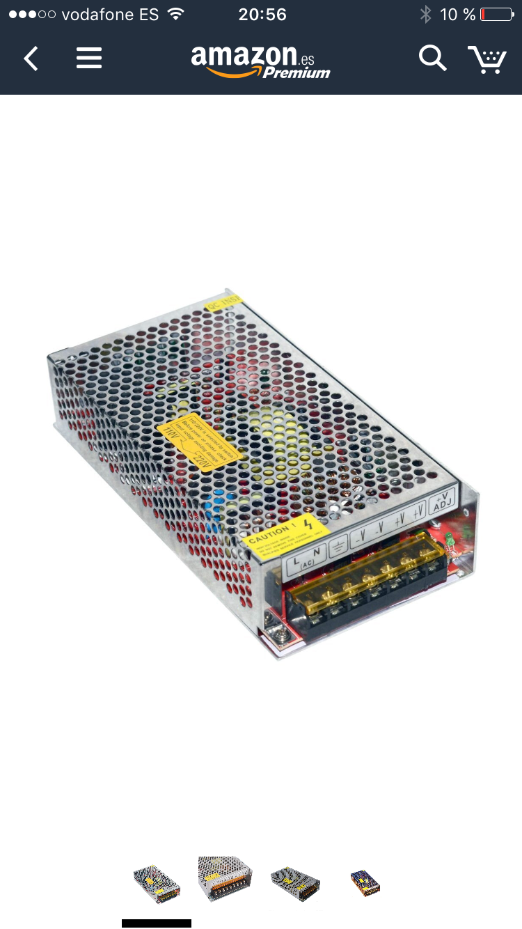

This is my power supply
I have a four channel wire which come from the power supply. This wire is connected to two wires, one connected to a 4m led strip and the other connected to a 2m led strip.
The interesting finding is that the main wire is receiving 12 volts. When I link the 2m wire, there is a volt drop receiving 10volts, and finally when I link the third wire, it only receive 8volts…
That’s the exact same model that was causing problems for my Fibaro RGBW Controller, it didn’t supply steady power, and sometimes made a hissing noise trying to turn the led lights on, I would get a different one, and you’ll see different results.
I have solved the voltage drop putting two transformer of 12V in series. My following question is what is the parameter I should use to be able to switch off the lights (from the wall switch) with one click. Currently, I need to to double click on the switch to be able to turn down the lights…

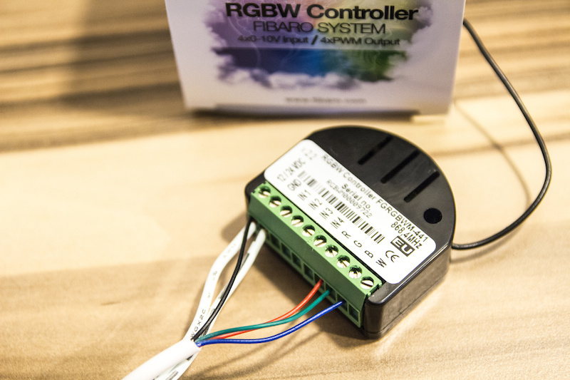

Cut off and splice the power supply end cord: you should have 2 wires:
  1. Ground (black)
  2. 12/24v (red)
Cut off one end of the strip connector and put all together using this picture
When you turn on the power, you should be able to “add a thing” to smarthings and control the colours

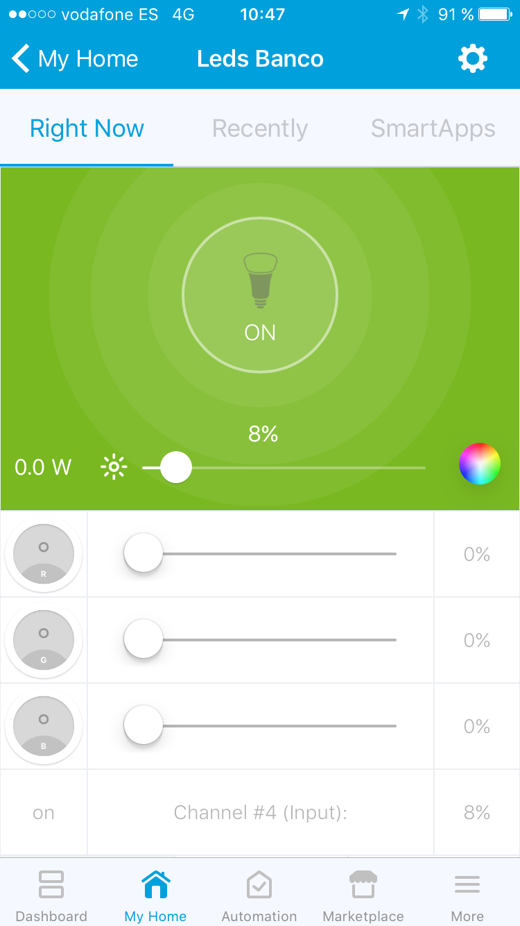

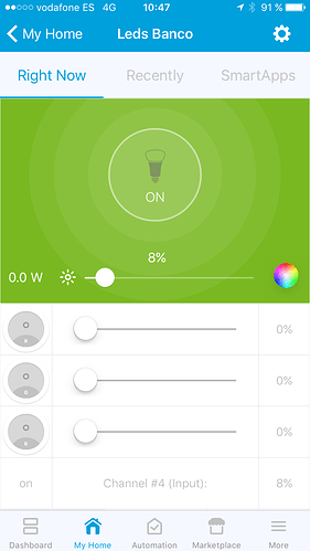

I don’t know what happened but in the last days the controller is not working properly. When I turn on the light, the color slider doesn’t work. For example, if I try to put Green or Red to 100%, no updates are shown, however in the logs I see these event. You can find a screenshot that shows Red and Green with the slider position into 100% but in the right box it says 0%
Another problem I see is when I turn on or turn off the lights, until I click on update button, no changes in the status are show. In the screenshot below you can see the status once click turn off. The sliders are in off, but the main status is still in on. On the logs I see turn on or turn off events.
Yours look different from mine, are you using a custom DTH for the fibaro?
